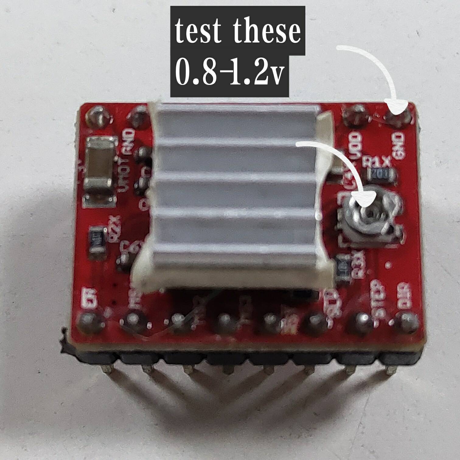

Hi, Can you provide specific videos?
You can try to swap the driver board,
or use a multimeter to measure the driver board. The voltage range is 0.8-1.2v.
you can refer to this:
A4988 测量位置.jpg (192.77 KiB) Viewed 10297 times
If your belt is loose, you can try to tighten it.

HI!... this A30M don´t have those drivers..
are you sure tell me what I must do....

I have read V in all drivers:
Motor E1: 1.333v
Motor E0: 1.306v
Motor Z1: 1.218v
Motor Z0: 1.160v
Motor Y: 1.318v
Motor X: 1.147V
do you think this is the problem?

Hi,You can try to reduce the voltage properly,
If possible, you can provide specific problem videos so that we can better solve the problem.
