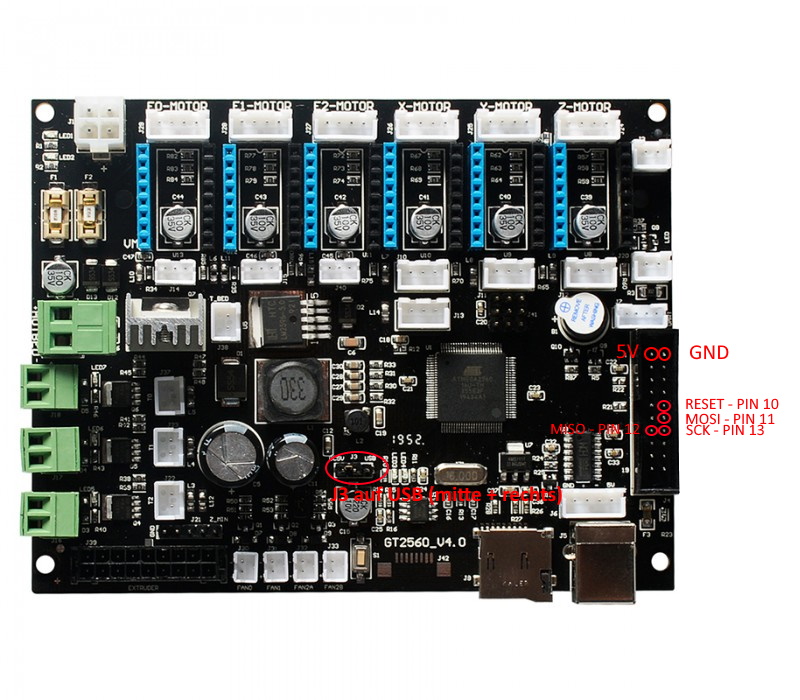

Can someone share a photo of how to connect a Arduino Uno to the GT2560 V4 Board to use the uno as a programmer? My board doesn't have a boot loader installed on it, and i need to flash the firmware to enable 3dtouch.

THE PROBLEM is that many of the A20T's were shipped without a bootloader, so you can't flash the firmware AT ALL.
I'm asking specifically about how to connect a Ardunio Nano board to the Gt2560 V4 Board to use the Nano as a programmer, so that I can install a boot loader. Can someone share the proper pins to use on the GT2560 V4 Board?

How i unbrike my GT2560 V4 board after powerloose during upload a new firmware:
Hi, today I successful unbrike my GT2560 V4 board from my A10 and i will share my steps.
first i test the pins of the atmegas to the lcd connector. then i looked around on the board to find out how i can supply the board and the arduino from the same power source. a protection circuit prevented this, but this can be deactivated by setting the jumper J3.
now i tried to burn a new bootloader using a Nano, Uno or Mega as programmer ("Arduino as ISP"). no variant worked, because either no connection could be established (e.g. "not in sync") or the checksums could not be verified.
in the arduino forum i came across the hint to try "Nick's bootloader sketch".
here are the steps that worked for me
  • 0. Unpluge your power supply
  • 1. flash the "Atmega_Board_Programmer" from https://github.com/nickgammon/arduino_sketches to an seperate arduino uno (only compatible with Uno and Mega), if you didn't have enough flash space, you can change the config to:
    Code: Select all
    #define USE_ATMEGA8 false
    #define USE_ATMEGA16U2 false // Uno USB interface chip
    #define USE_ATMEGA32U4 false // Leonardo
    #define USE_ATMEGA168 false
    #define USE_ATMEGA1280 false
    #define USE_ATMEGA1284 false
    #define USE_ATMEGA2560 true
    #define USE_ATMEGA256RFR2 false // Pinoccio Scout
  • 2. wire the PINs as shown in the pinout picture below to this arduino uno
  • 3. switch the jumper J3 from DC5V to USB (from left+middle to middle+right), this is important because you must power the board with the 5V-GND pins from the UNO
  • 3. connect the UNO to the PC, open Arduino Studio and the Serial Monitor (you can use any other serial monitor too)
  • 4. send the command 'C' via serial monitor if you can see "Type 'C' when ready to continue with another chip ..." or go the next step
    if you see "Failed to enter programming mode. Double-check wiring!" repeated from step 2
  • 5. wait unit you can read "Type 'G' to program the chip with the bootloader ..."
  • 6. press 'G' and wait until "Done." and "Type 'C' when ready to continue with another chip ..." is shown in the serial monitor
  • 7. flash a new firmware
  • 8. switch back the jumper J3 to DC5V
The PINOUT:
You can read more about the Atmega Board Programmer there: http://www.gammon.com.au/forum/?id=11635
