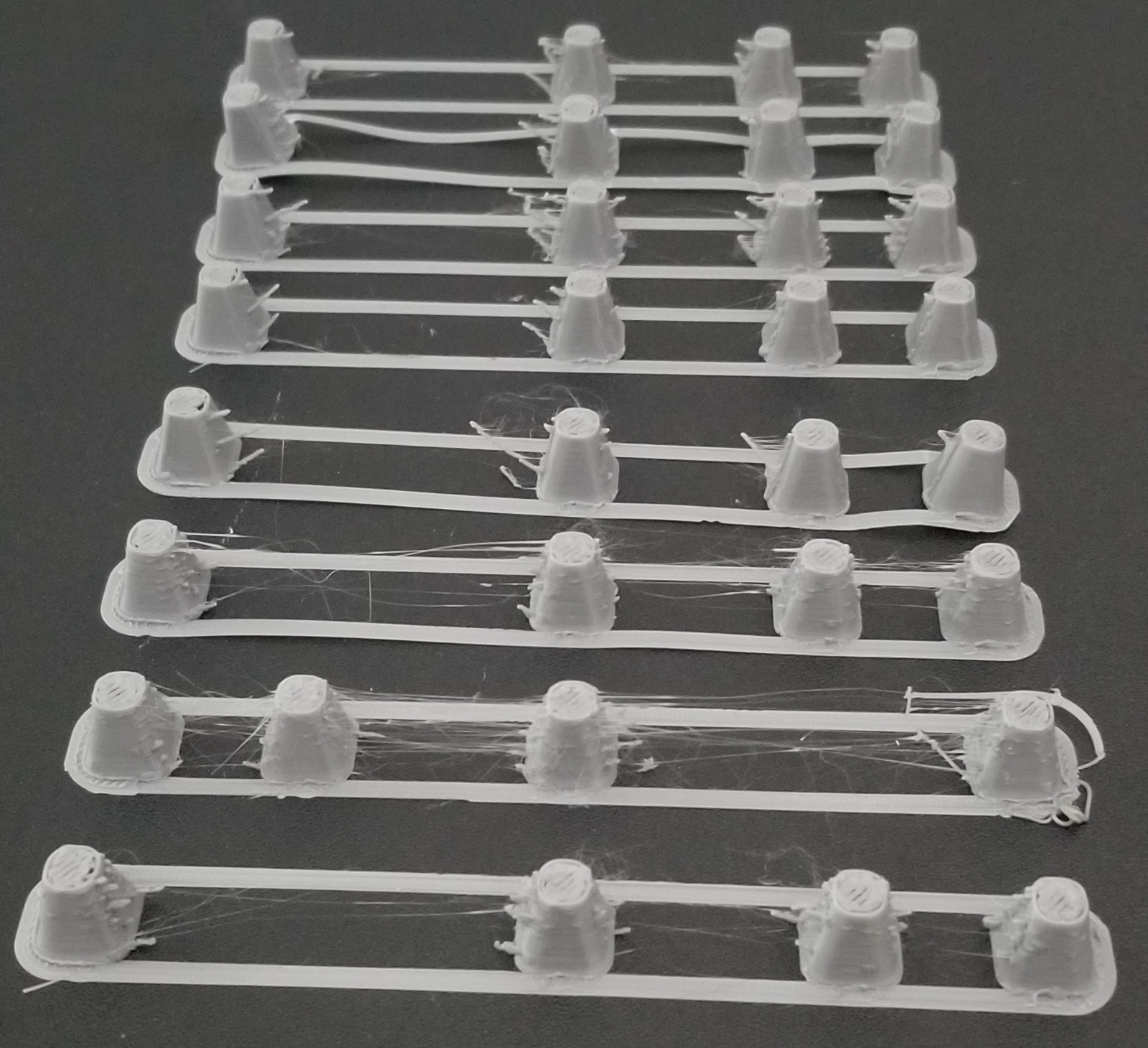

Here is an example of just a fraction of the test prints I've run. For the life of me I CANNOT get rid of this stringing! The best sample here has a coast volume of .2mm³ and has terrible under extruding toward the end of each retraction, and I'm still getting some stringing...

So after going through the hot end and removing the small disks, I've gone through and tried adjusting every setting I can think of with no real luck increasing my print quality with Cura. Disheartened, I went back to Simplify3D and have gotten same really amazing quality prints!! Unfortunately, taking those same settings back to Cura does not provide the same quality. Anyone out there willing to share their Cura settings for PLA+?

So just an update...
After trying everything I could think of in the settings, removing the restrictive plates in the hot end, and printing over 100 test prints, it dawned on me that it could be my firmware. Sure enough, the stock firmware limits the retraction speed to 25mm/sec, regardless of what you have any of your settings at in any program. After updating to Marlin 2.0.1 and removing such restrictions, my prints are beautiful comparatively!! Still need to dial it in but the stock 6mm and 45mm/sec seem to be working extremely well! Will post my setting once I have everything dialed in
