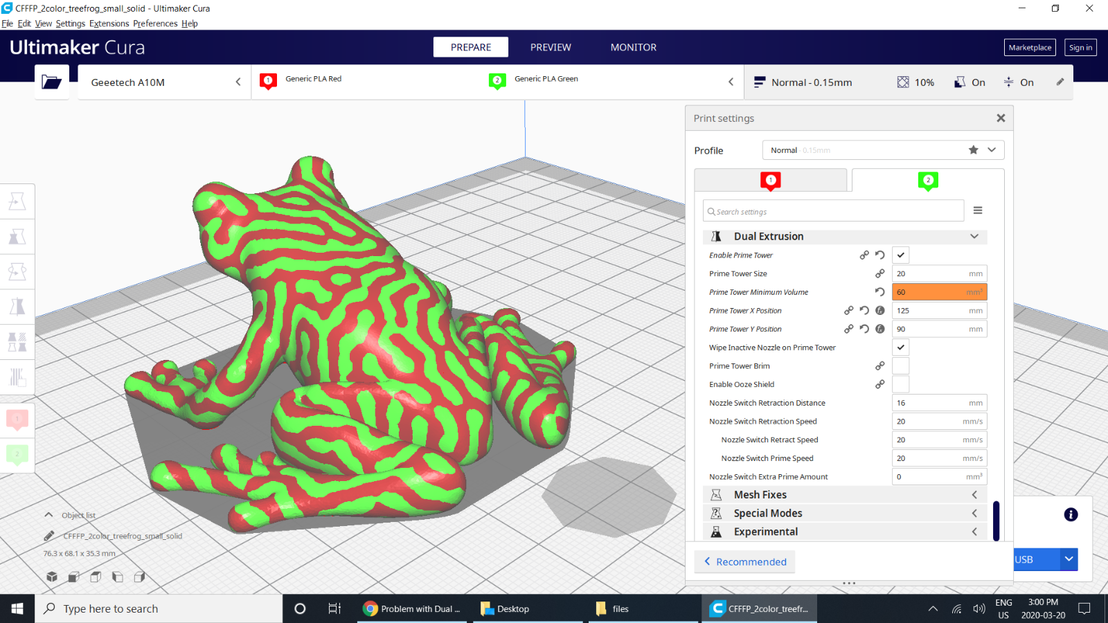

Hello, I have been using Ultimaker Cura 4.5 version to slice the dual-color 3D model. I assigned both extruders for two parts in the model (as attached here ).
dual color.png (942.35 KiB) Viewed 13351 times
I also selected a prime tower with 60 mm3 minimum extrusion volume. Unfortunately, I see, the printer (Geeetech A10M) is printing using only extruder 2 (which is E1 in gcode, I guess). Can someone help me? Also, please advise me how much volume I should use for this Bowden type feeder. Many thanks.

Hi, after the two models are fused, the extruder is selected for the two models.
Increase the Prime Tower Size to around 20 ~ 25,
Prime Tower Minimum Volume tries to increase to around 15 ~ 18,
Changes to Prime Tower Minimum Volume as Cura preset parameters are exceeded.

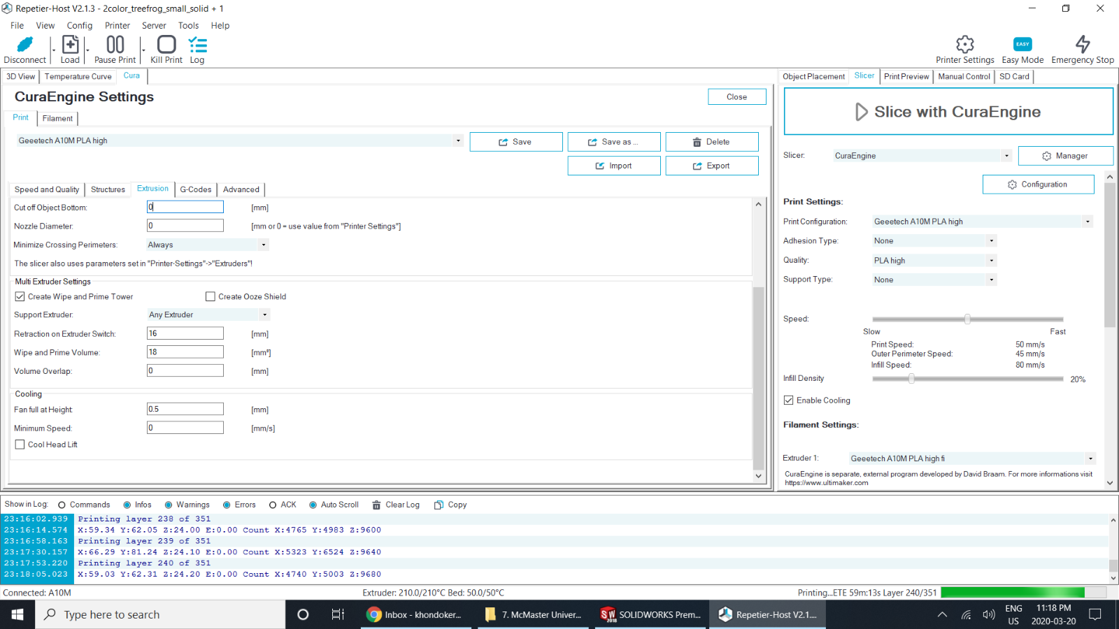

What would be "Retraction on Extruder Switch"? The default value is 16 mm. Also, in CuraEngine I don't see the option to put the "Size of Prime Tower".
Any help?
Re: Problem with Dual Extrusion [only E1 prints]
Posted: Sat Mar 21, 2020 11:53 am
by William
Hi,you can choose the Dual Extrusion.
