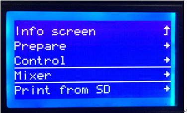

Hi, you can adjust the color mixing ratio on the screen 0: 100 is the second extruder work:
1. Select "Mixer", press the knob, turn the button to select "Mix: 0%; 100",
adjust the mixing ratio, and press the knob to confirm the setting.
2. To quickly switch the ratio between E0 and E1, select "Toggle mix" to switch.

ok but where could I found "mixer"? I cannot see it...
Re: how print only with 2nd extruder with cura
Posted: Thu Apr 23, 2020 6:01 pm
by William
Hi,it is on the main menu.
