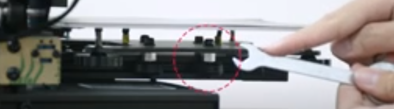

Hi all, having problems trying to level heated bed. I find that 2 of the adjusters are at the limit of their travel and do not allow the bed to rise high enough for satisfactory levelling.
How do I remove the bed plate to get at the adjusters to fit them with washers to raise the plate?

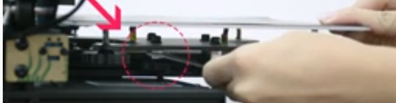

Hi,you can unscrew the screw and then remove the hotbed as shown below.

Thanks again William. How many nuts need to be removed to lift the heated plate? Looking at it quite closely it is very warped down the side that won't level. Is it straightenable? (is that a word???)

Hi,All four are adjustable. If the height is still not enough, you can also adjust the level switch by adjusting the Z axis.
