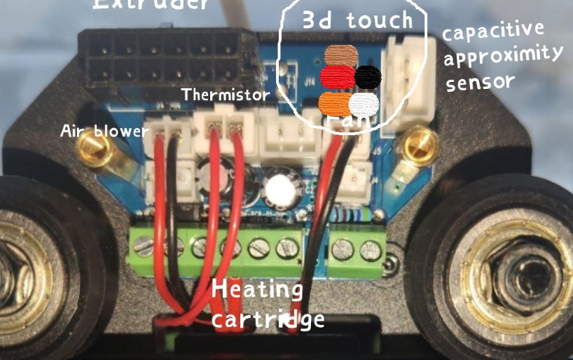

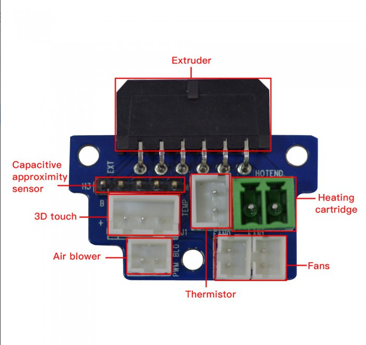

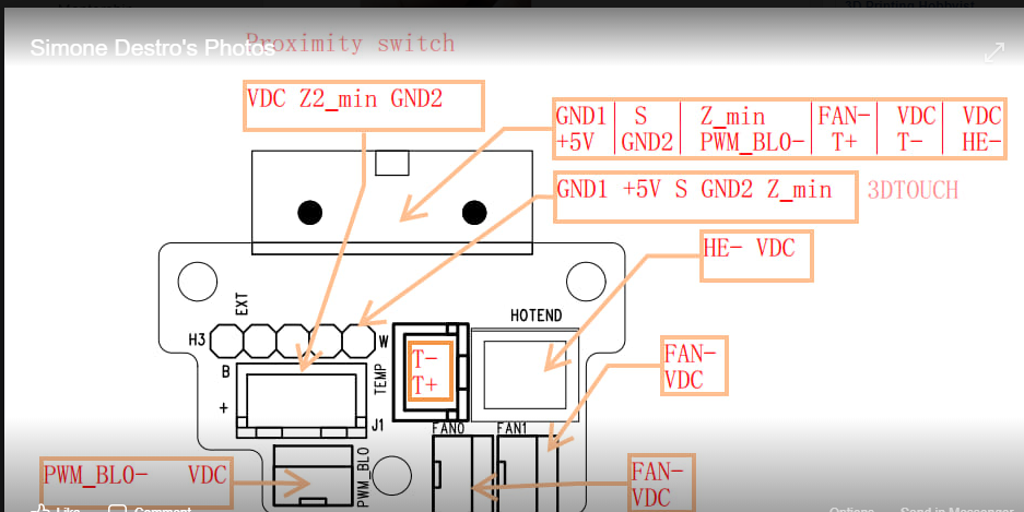

just replace the 3 color hot end but missing the connectors diagram...anyone ???
Re: A10T
Maybe this can help you.
