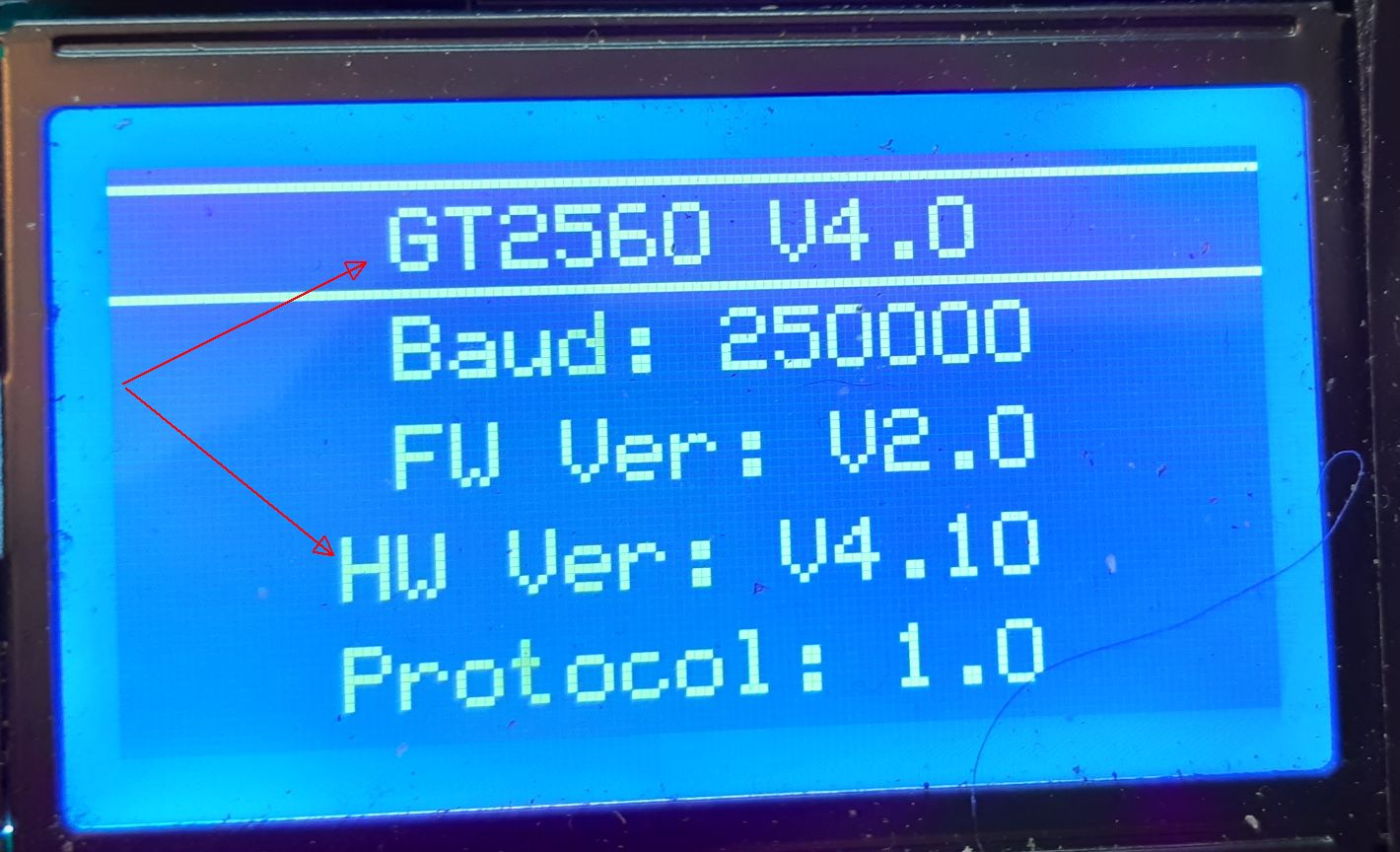

hi I hope someone can help me, I bought a 3d Touch to self-level the print bed for my A20 printer, but I don't know what to do to configure the 3d touch, in the information board it says, that I have a 2560 V4.0, but in the third line says HW 4.1, I don't know which firmware should I download?
I attach screnshot of the info
Thanks to those who answer me
Regards

I think in a20 download you have a 4.1 firmware whit 3dtouch.....
