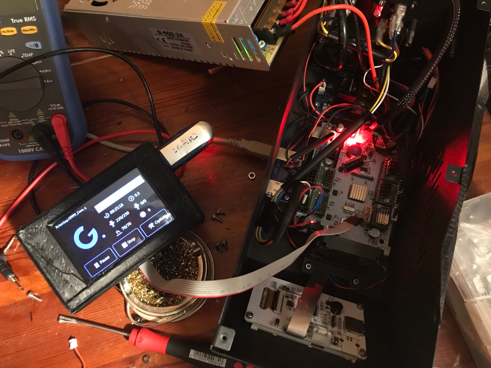

For me it was forced decision. I tried to slightly adjust Extruder motor current and managed to burn out my A30 main board. As long as after 3 months of use I was quite tired about amount of bugs in official Geeetech firmware... I didn't wanted to restore the same configuration anymore. Big hardware modification was not an option for me as well (I wanted something where I could just plug existing wires and that's it). After quick investigation, I decided to give a try and upgrade my A30 with GT2560 v3.0 board used in A10 printer. I can confirm that all cables from A30 fits to this mainboard with minor exceptions - 2nd Z axis cable should be plugged to E1 connector instead of E2 connector in original GT32, filament runout sensor and 2x BL-touch cables 2pin and 3pin should be slightly modified (pinout is the same, but GT2560 have a bit different type connectors onboard, with longer distance between pins). As as original Geeetech display is not an open source, it was disconnected and left as it is to close hole in the case. As display/control point I selected TFT35 touchscreen/serial G-Gode controller (to connect it You will need to solder TX3/RX3/5V/GND connector to GT2560 board). Micro SD reader on the controller case was left unconnected as well, it is not needed when you use TFT35 who has USB and SD interfaces onboard.
I've attached modified version of A10 Marlin 1.1.9 firmware (to fit upgraded A30) and picture with connected cables for those who want to try doing this by themselves. Please do not expect any support from my side, I'm not often guest in this Forum.

- Picture of connected GT2560 in the A30 controller case
- IMG_0460.jpg (319.32 KiB) Viewed 9703 times
