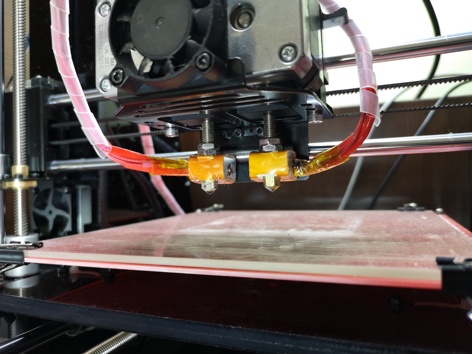

I've just moved to a new house and brought my I3 Pro C with me. It was working perfectly before the move. The first time I tried to turn it on after hooking everything up it blew one of the 15A littlefuses on the board. I replaced the fuse, tried to turn on the heater for extruder 1 manually from Repetier Host and the fuse blew again.

Which thermistor are you referring to? There seems to be a bit of black colouring on the plastic surrounding the wires coming out of extruder 2. Maybe it was not there before, maybe it was.

William is right about the 15A fuse circuit, there must be a short circuit somewhere.
Your observation can be helpful in diagnosing a fault.
First try to disconnect this circuit and check whether the fuse will be blown again. If not, you already know where to look for a fault
