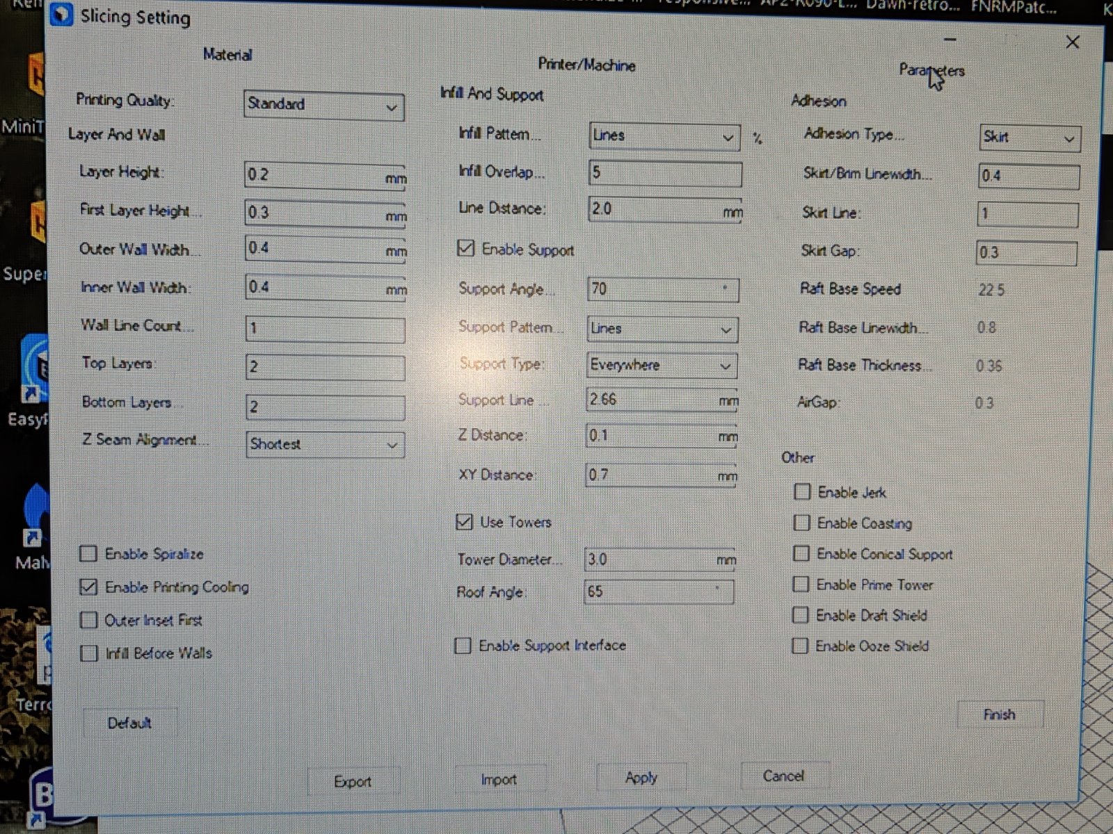

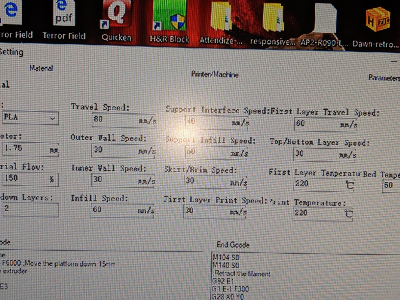

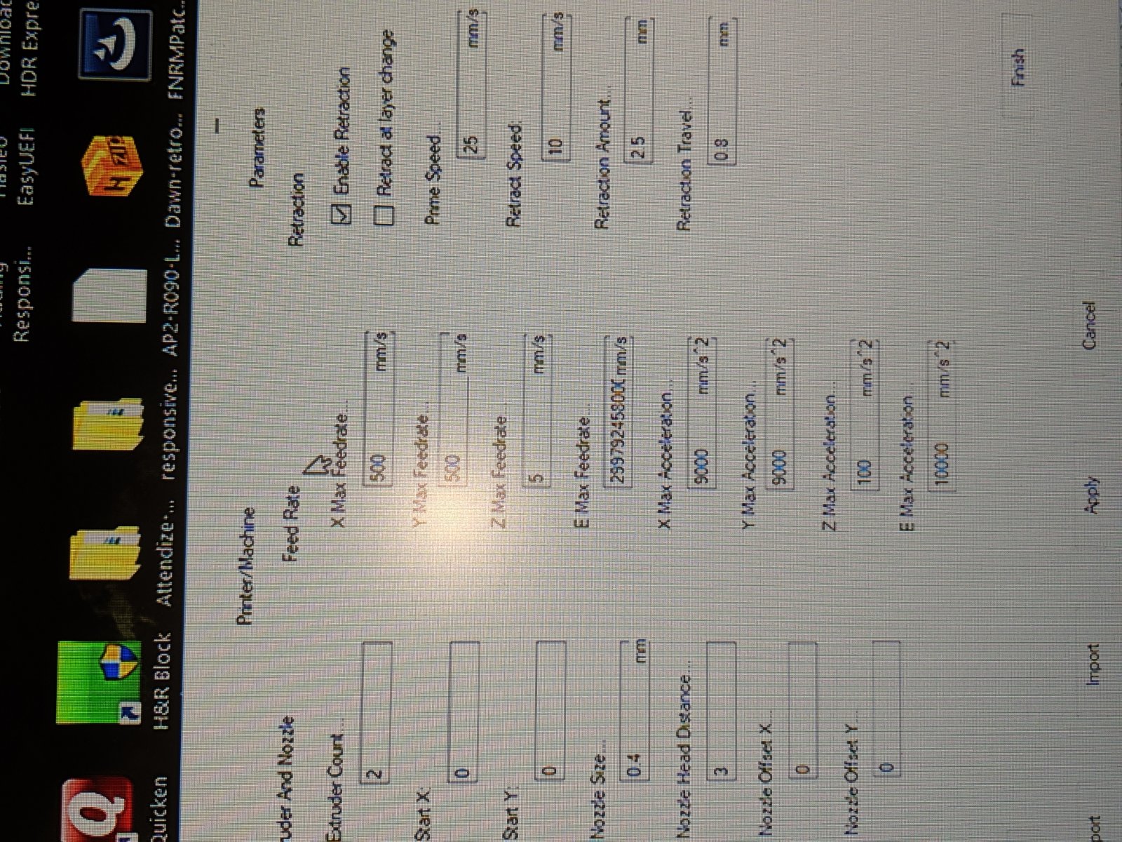

Hi everyone, I finally have my M201 all setup and tested all axis to make sure it runs smoothly. I downloaded a simple sharks tooth file opened it in easyprint3d with all the following settings (see pics) when I slice it and print my filiment comes out at first like string then starts to blob up and then nothing. Can anyone please help

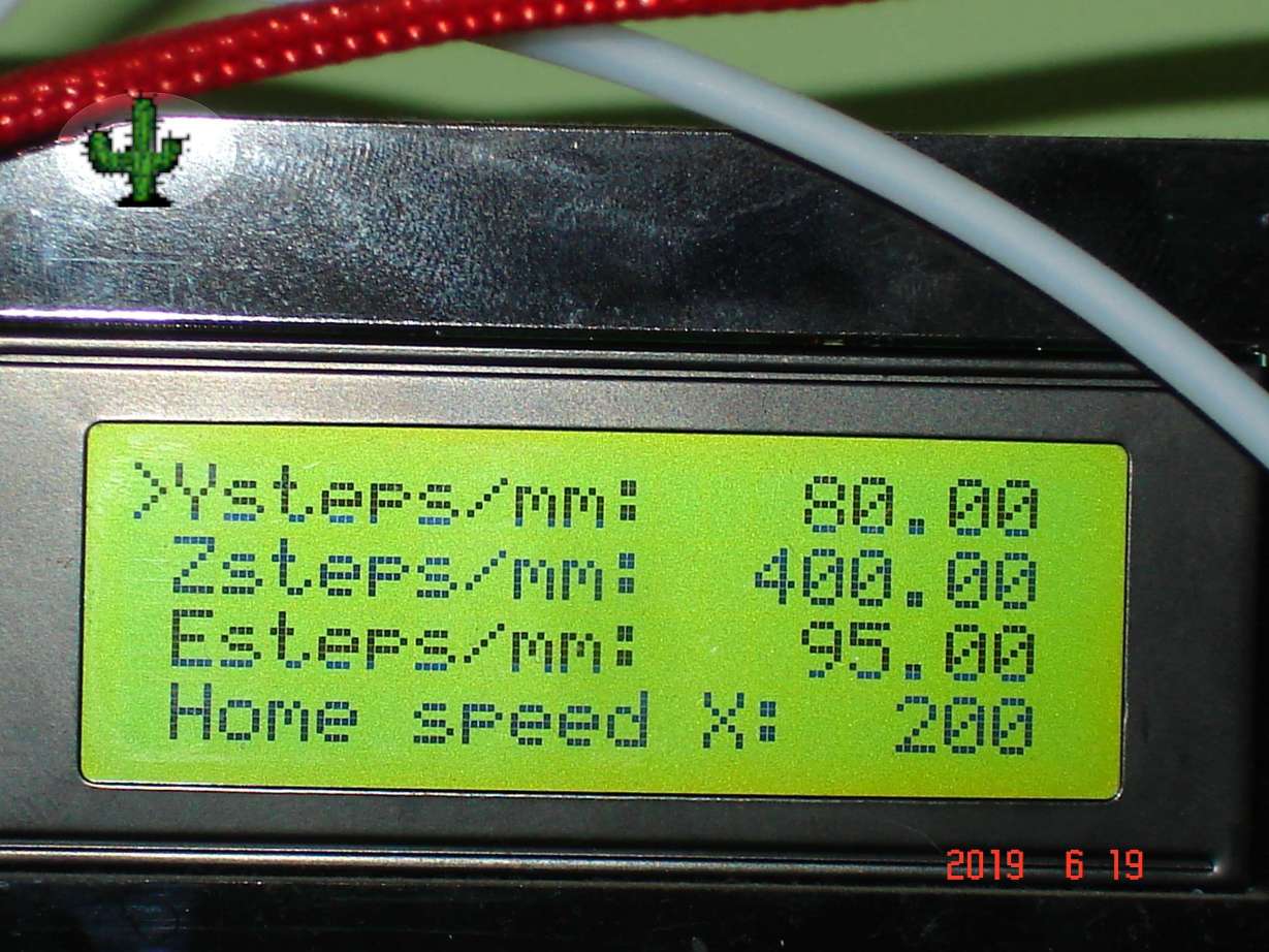

In my case, the default setting of the number of motor steps per rotation was not correct.
Look at the photo:
As a result of the calibration, I had to correct this value(esteps) to 101.

Kactus thanks, while sometimes it is a little hard to follow, I can understand for the most part. But what I am confused about is that you told me to measure the extruder step and if need be change it to 1mm. I do understand the estep however you said you changed to 101 but your screen shows 9* something.
I do not understand where I need to change things to 1mm if extruder step doesn't match. And how do I figure out how much I should change estep.
