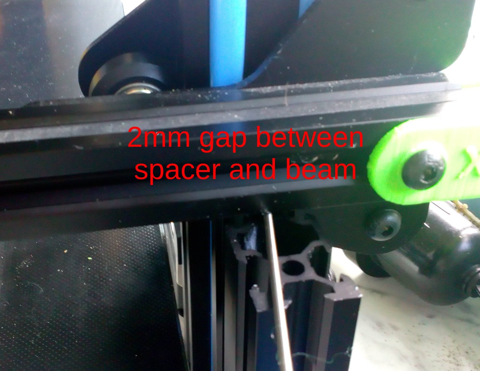

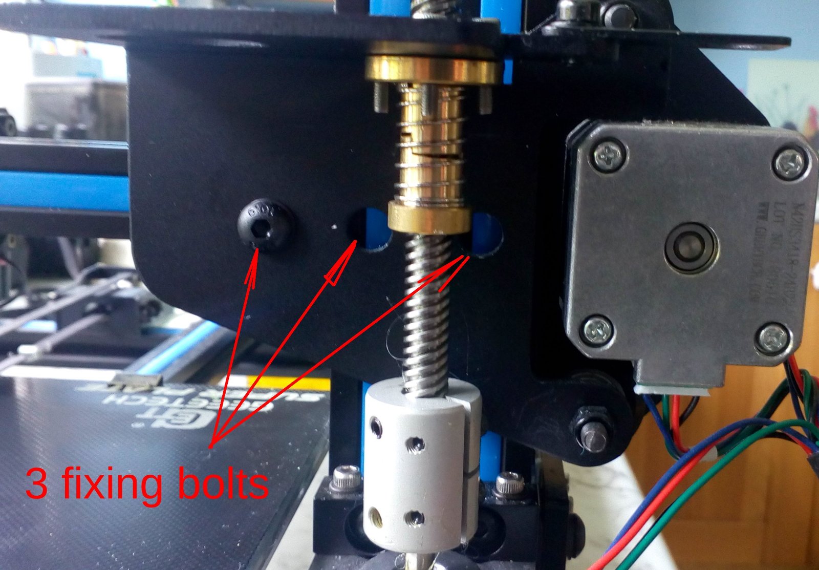

I've own my A30 for 9 months now and generally it is great, the only problem I do get is the X axis level. Out of the box I used the spacers and level the X axis, it wasn't happy and I could feel some pressure winding the right hand lead screw to level it. It worked fine but kept I had to constantly re level the bed on one side. After a while I could see the bed was now a couple of mm out, I checked the beam and it was 2 mm higher on the idler end. I re-leveled the beam and then the bed but gradually it happened again until around the 2 mm mark it stops needing adjustment.
Today I removed the bolts that fix the Z carriage to the X beam on the idler side. The spacer was under the motor side and I had the 2 mm gap the other side. On releasing the last bolt nothing happened You'd expect it to drop either with stress or gravity up it stayed 2 mm above the spacer. That explains why it always end up 2 mm out.

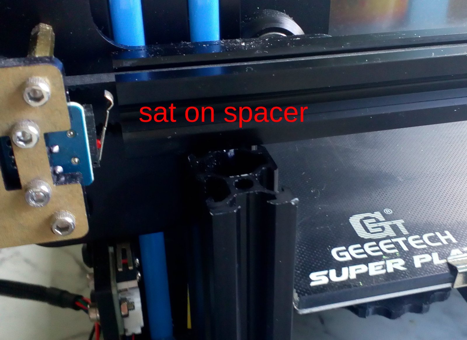

Today I disconnected the idler side of the X beam and stayed where it was 2 mm too high. (See photos)
IMG_20190624_152118_sat on spacer.jpg (228.68 KiB) Viewed 4985 times
other side
IMG_20190624_152124_2mm clear.jpg (259.01 KiB) Viewed 4985 times
Anti Rattle bearings
And Other side
IMG_20190624_153432_2 hole lead no where.jpg (249.08 KiB) Viewed 4985 times

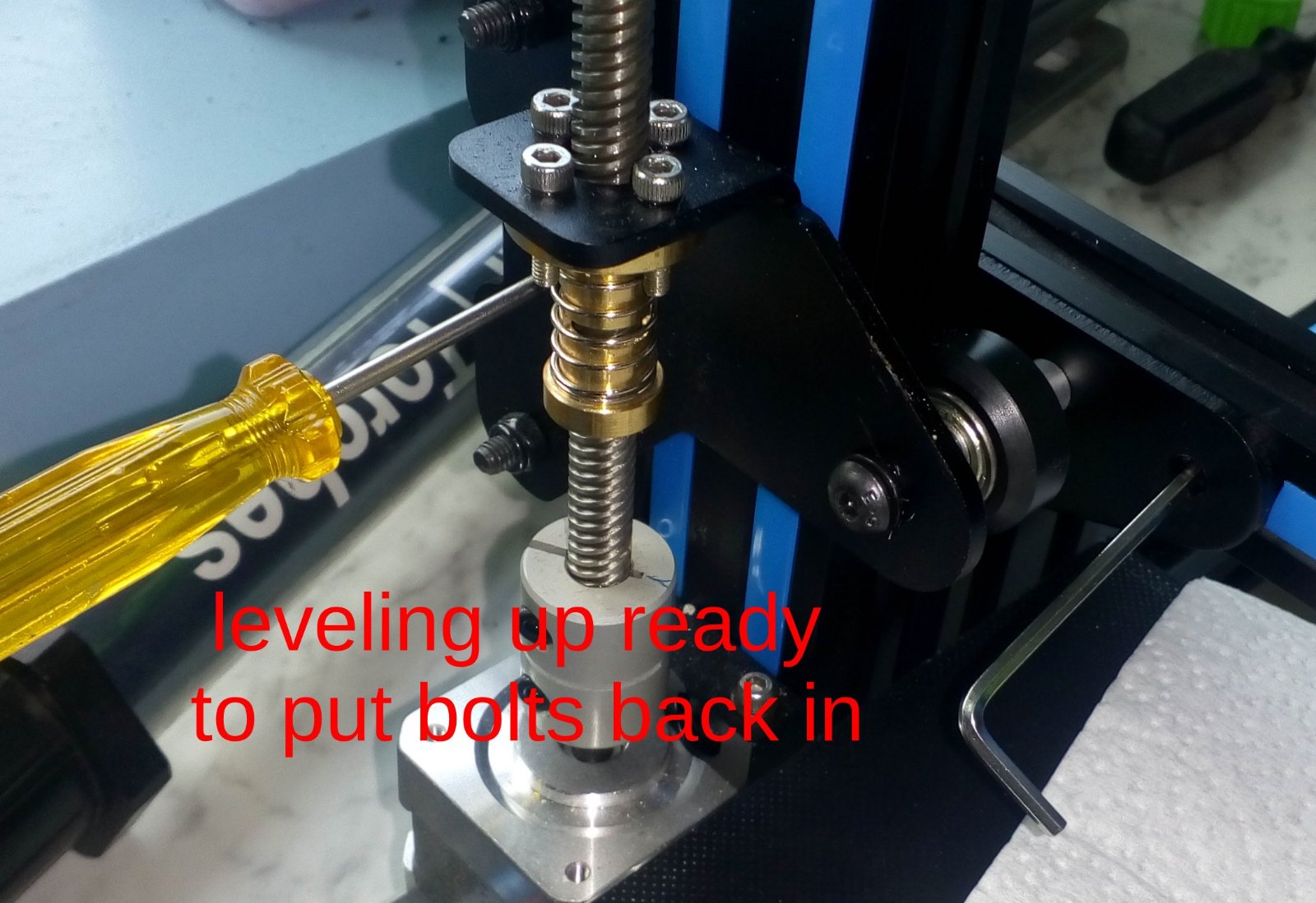

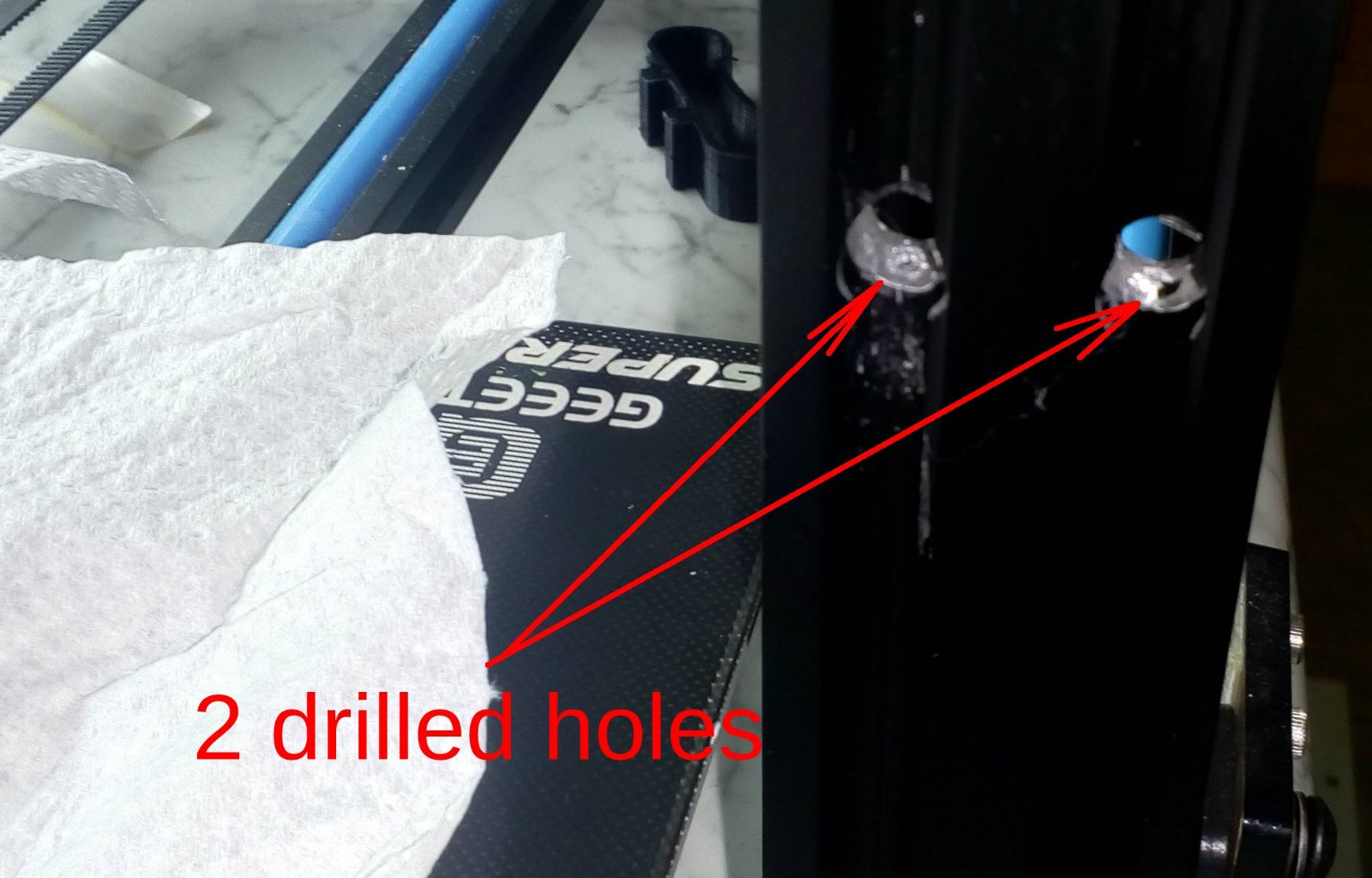

Looking at the other end where the Stepper motors are there are also 3 screws but 2 are hidden behind the vertical beam. So I remove, lead-screw, motor and the plastic infill strips and rested the beam on the spacer.

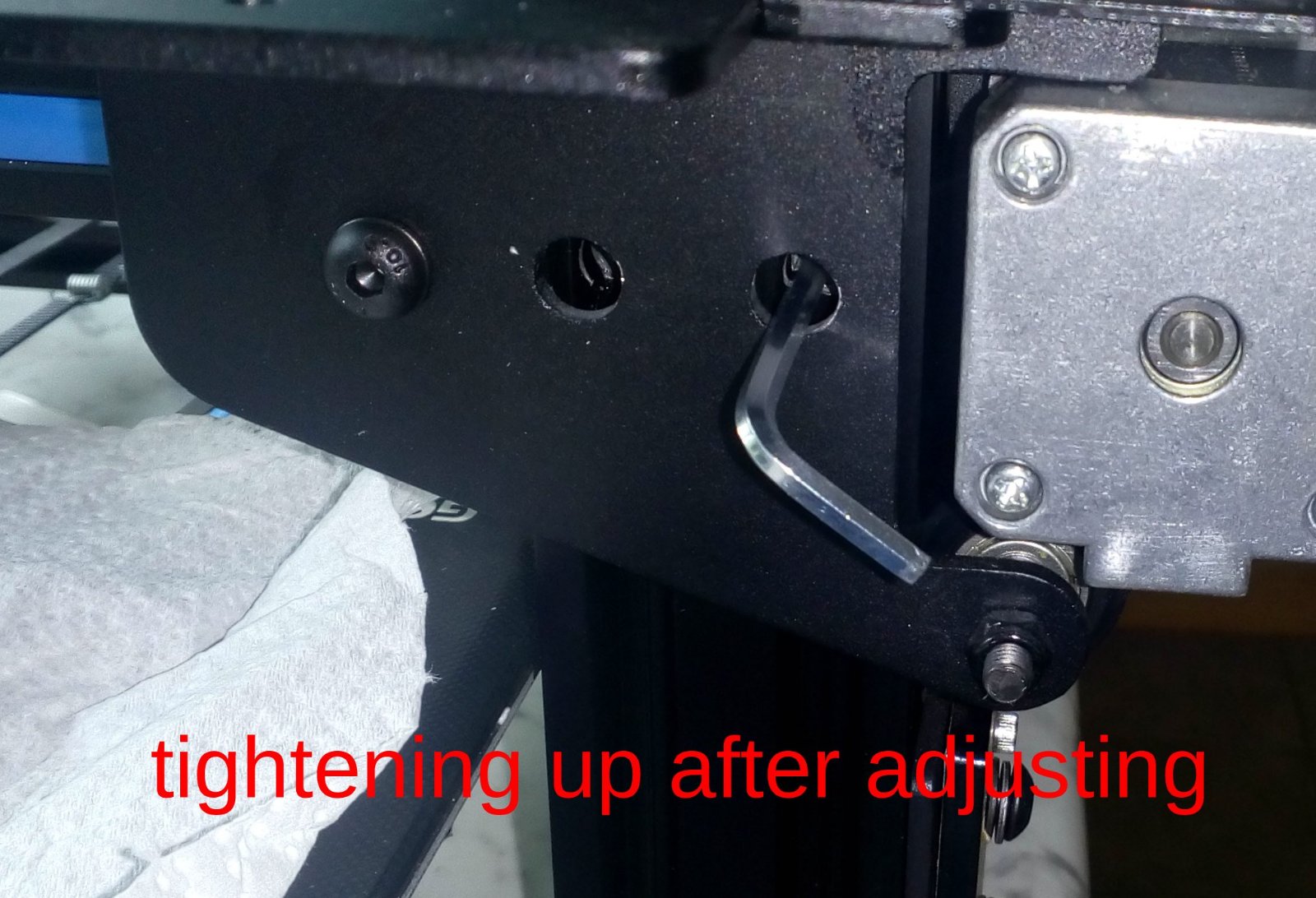

I took a drill and marked the beam where the 2 holes are in the carriage and then removed the vertical beam and drilled both the holes.

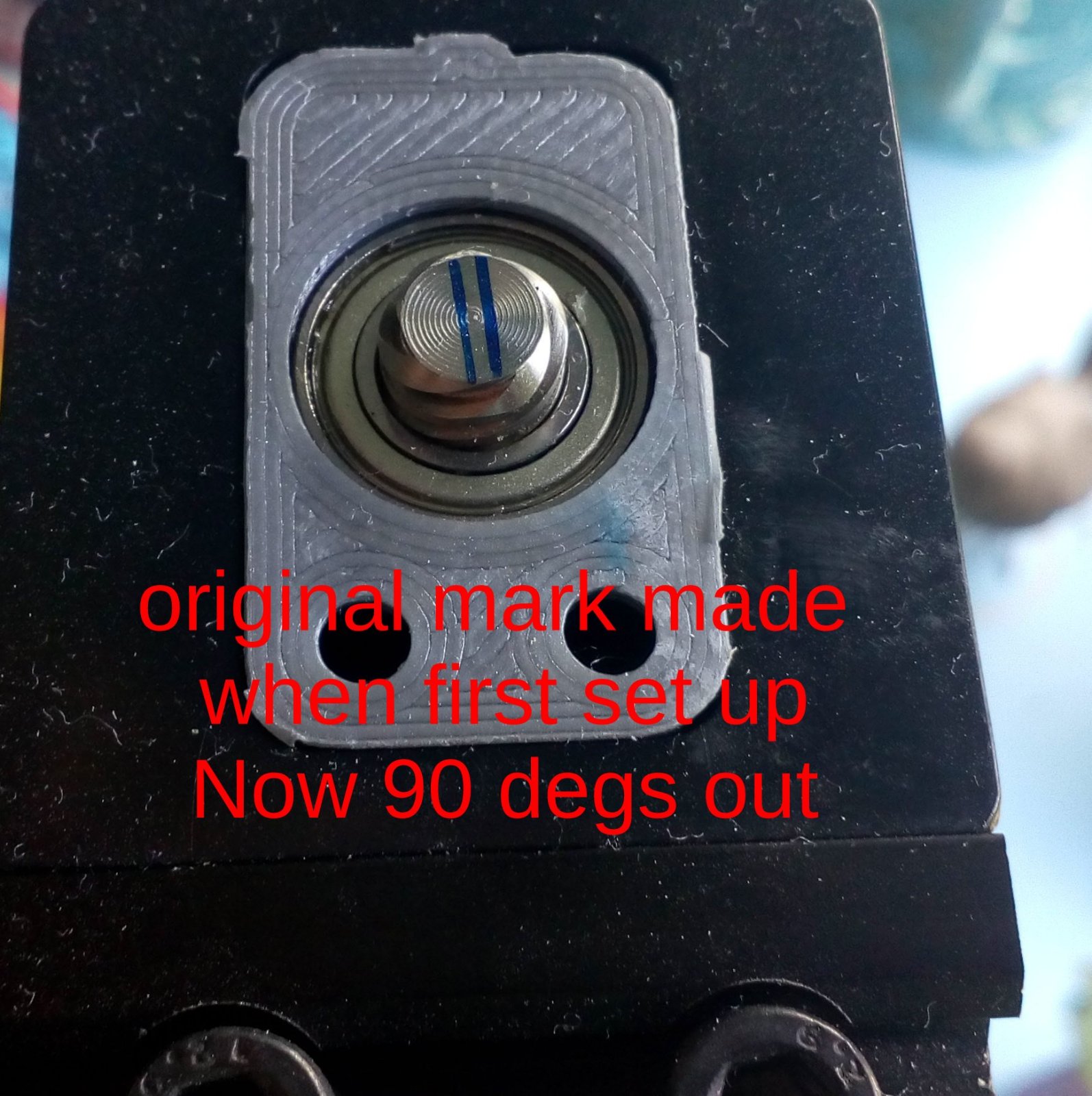

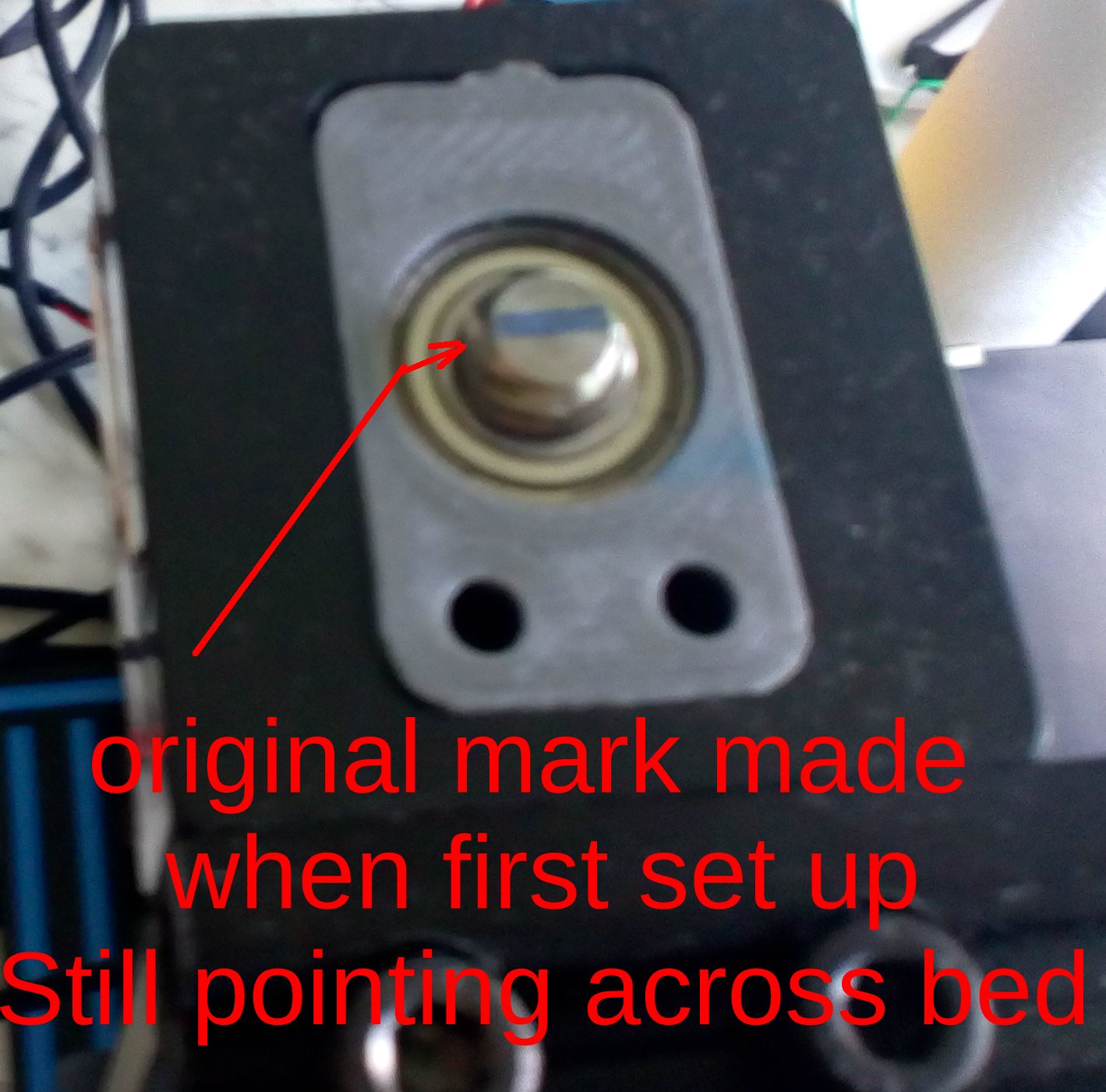

Cleaned and reassembled leaving the screws from the carriages into the X beam loose and rested them both on the spacers and tighten them up. I will re mark the Lead-screws and see if they stay in sync.
IMG_20190624_161935_tightening _beam.jpg (255.62 KiB) Viewed 4985 times
I remember thinking when I first set it up that it felt like I was tight when leveling it. Now there is no preload so I hope it will not skip one side or the other.
