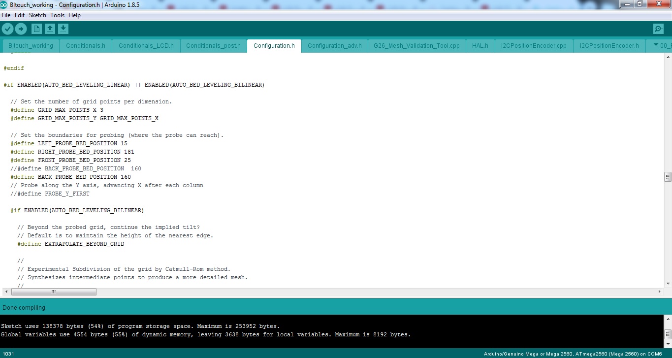

I've just "upgraded" my Geeetech I3 Pro B with a GT2560 and a 3dTouch probe. All is working well except for one issue that I am unable to solve within the firmware.

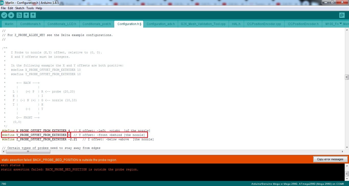

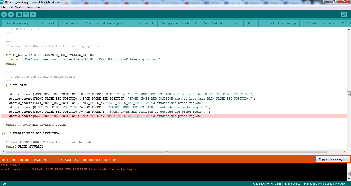

When probing the bed to level it, the probe goes off the back of the bed. To remedy this I changed the maximum probe parameters in the firmware, however when I try to change the probe offset numbers, specifically the Y probe offset from the extruded, I get an error message. This only occurs when I change the value to a positive number, it does not occur with numbers that are zero and negative. It also changes to the sanitycheck tab when the error occurs.
I have attached a photo of the error and the firmware saved file as I am not all that good with coding and changing of firmware. Any help is appreciated.
My printer has a print size of 200x200x180 and the probe is offset by 4mm to the right of the extruder when facing it and 40mm behind the extruder.
