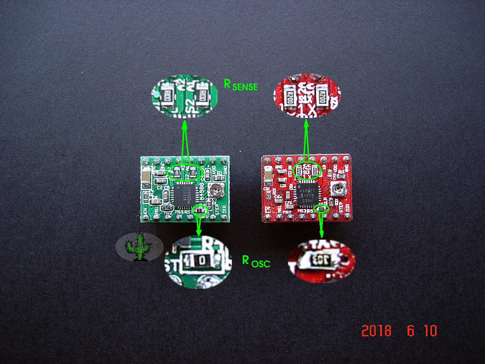

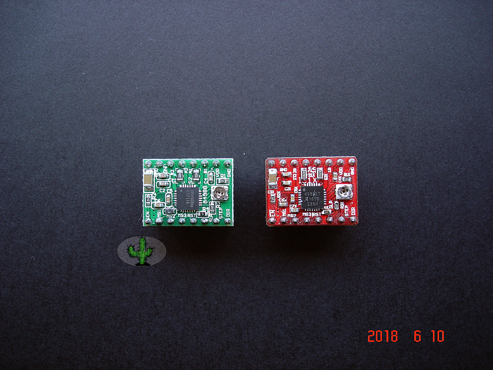

the picture below presents the modules that can be purchased in popular trading platforms:
At first glance, the modules only differ in the colour of the soldermask, but is that the last difference?
A seasoned observer will notice the details that make these constructions unique.
And it is these details that give the individual features of each of the presented modules.
Of course, by limiting the functionality of the driver's chip. :lol:
The modules are distinguished by resistors in the motor circuit and the operating mode control circuit.
From now on, with new knowledge, everyone can individually influence the performance of the module and change the driver's operating mode.

However, it must be said that it concerns the new version of the Polulu module, contains better customized resistors in the motor circuit (Rsense), and has a slightly differently constructed reference voltage circuit (Vref) for output current regulation. :D
To correctly calculate the Vref setting for the current to be supplied, read the value of the Rsense resistors and use it in the calculations.
To achieve this, you should also know the operating parameters of the stepper motor.
The regulation can also be done experimentally, but it is important to note that motors or driver chips can easily reach dangerous temperatures.
The whole process is described in detail here, so I will not repeat it.
