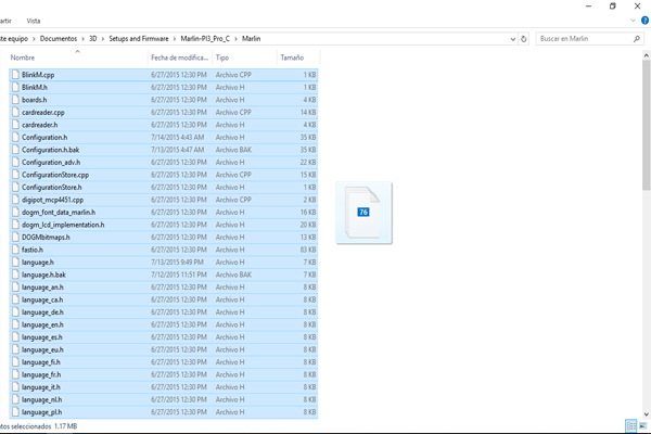

I downloaded the Arduino 1.6.5 for windows from web and the Marlin_PI3_Pro_C from another forum topic here.
I installed the Arduino without problem and followed the instructions from this topic http://www.geeetech.com/forum/viewtopic ... 20&t=16433

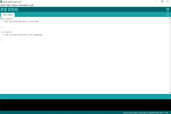

I Open Arduino and select Arduino Genuino Mega / Mega GT2560 board
Drop all the Marlin files on the arduino

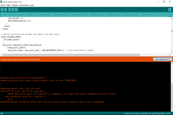

but when I click on "Verify" arduino let me a compiling error
Arduino:1.6.5 (Windows 8.1), Placa:"Arduino/Genuino Mega or Mega 2560, ATmega2560 (Mega 2560)"
temperature.cpp: In function 'void manage_heater()':
temperature.cpp:665: error: unable to find a register to spill in class 'POINTER_REGS'
temperature.cpp:665: error: this is the insn:
(insn 98 97 100 4 (set (reg/v:SF 103 [ pid_input ])
(mem:SF (post_inc:HI (reg:HI 146 [ ivtmp.209 ])) [4 MEM[base: _110, offset: 0B]+0 S4 A8])) temperature.cpp:449 99 {*movsf}
(expr_list:REG_INC (reg:HI 146 [ ivtmp.209 ])
(nil)))
temperature.cpp:665: confused by earlier errors, bailing out
with this error arduino don´t let me transfer firmware to my Prusa.
anyone who can help me, or has the same error
Thanks

How about using arduino1.0.1, and this is the latest firmware for I3 C.

Wow thanks Mark, I download the arduino 1.0.1 and compiling perfect the new firmware, tonight I will try to upload it to my Prusa and test my printer axis steps dimentions
