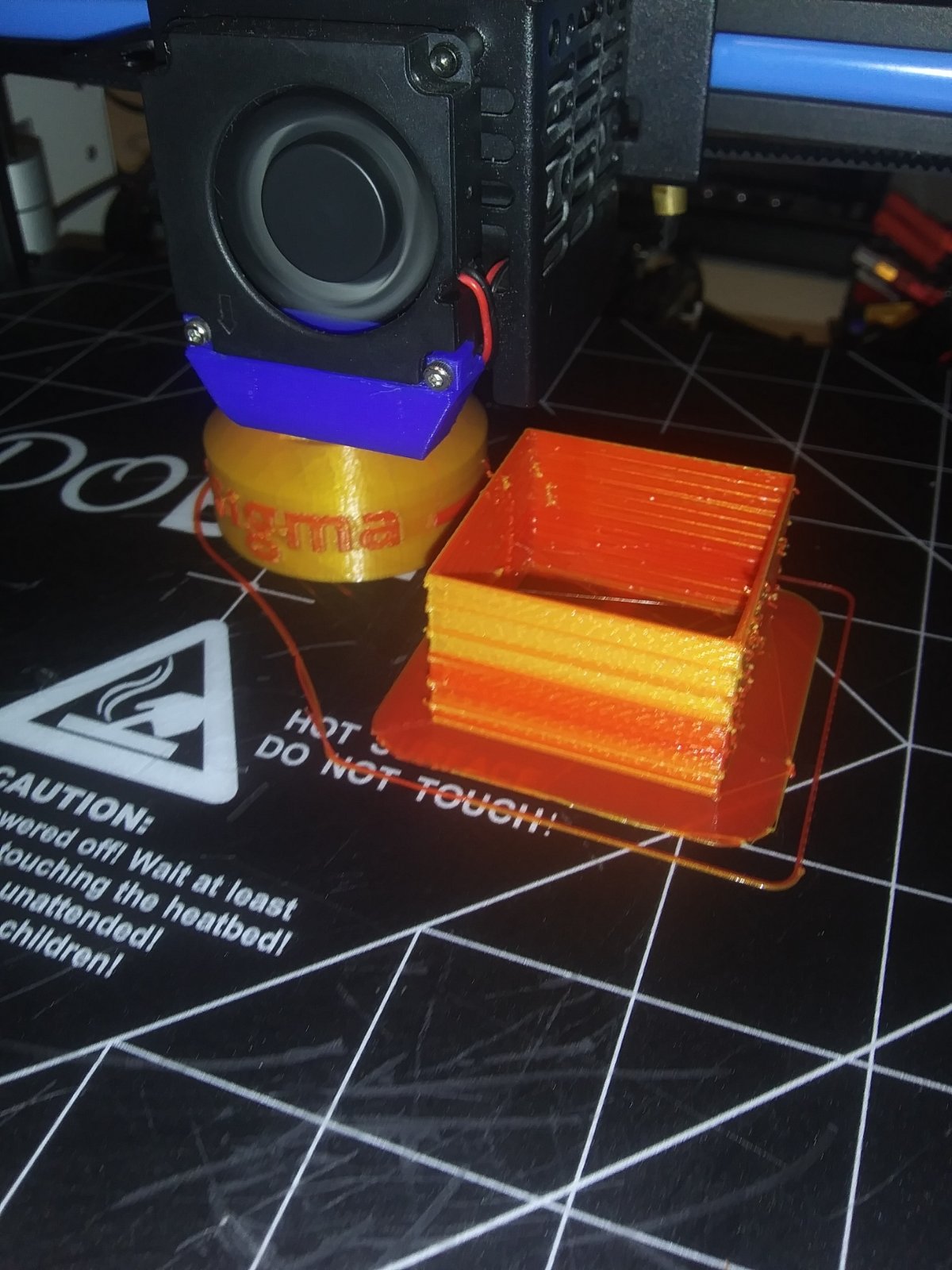

Re: A10m Pausing at Purge tower.
Just a pic of the latest print! This was a total mess yesterday. I think I finally whooped its but! ![Image]()
