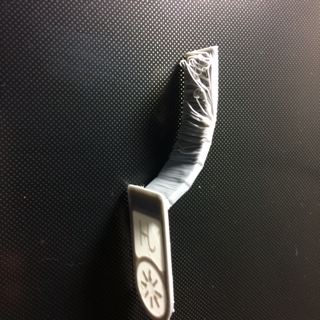

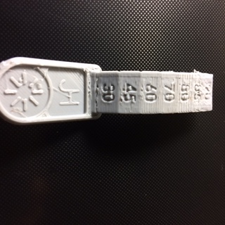

I have been playing with the CURA settings last couple days trying different calibration tests. Here is the extreme overhang... didn't turn out so well. I get a lot of globs while printing and I have to pull the first few lines of the skirt from the bed because they not sticking or super stringy and globs sticking to the hot end tip.

are you using the stock hotend? my filament keeps oozing out and then sticking to the nozzle and blobbing up on the print causing failures or just ugly prints. Please PM me or put up some screen shots on this post of your CURA settings to print PETG please.

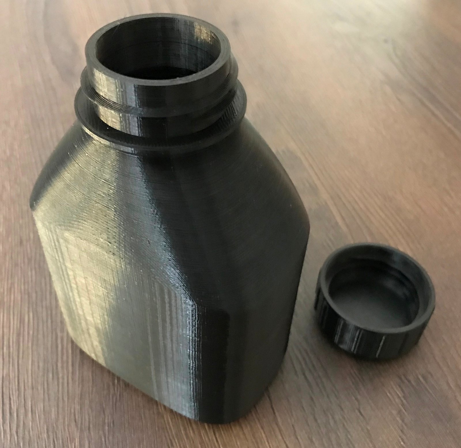

I use PETG on the constant basis. Print temps 240C/75C. Speed reduced to 10mm/sec 1st layer and 60mm/sec all others. I have not much left from original components on my A30 :). Mandatory mod to print with PETG - replacement of standard extruder to geared extruder (I use 5.18:1 geared extruder from Ebay). Otherwise speed should be significantly reduced or You will get constant jams. Another thing - use of quality PETG with good tolerances (i.e. 3Dplastx). Replacement of standard Geetech printhead to something more suitable (like E3D Volcano) can help to improve print speeds as well...
In general - I like this material. No 6 months term until degradation, like PLA. No wrapping like with ABS, much better layer adhesion than ABS (no breaks between layers even on veeery big parts!).
Bottle. Black 3Dplastx PETG. 1.75mm, 240/75C, 0.15mm layer
