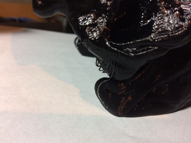

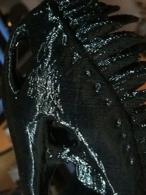

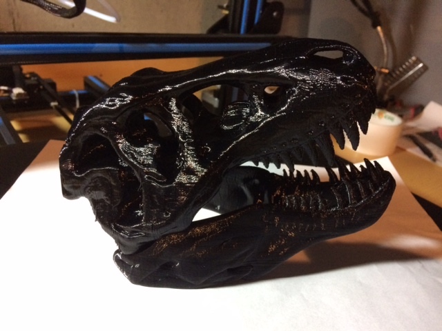

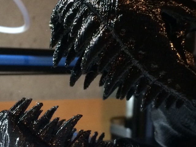

Thank you for posting back. I have been continuing to play with the settings, but will definitely look to upgrade some parts on the A30 and slow it down more. I have only printed with PETG since I received this printer with some decent prints. I am using Hero3D PETG and AmazonBasics, the Hero3D seems to print better than the AmazonBasic. It could have been the extruder tip was dirty, or the filament had moisture. I think I am getting close to a good Cura profile for 0.4mm nozzle, I want to try a 0.6mm nozzle for larger and quicker prints. Here is T-Rex skull with Hero3D PETG and 0.4mm tip, 0.2mm layer height, 53% print speed, 240/75 temp. There is still definitely some tweaking I need to do. The camera on my phone sucks, sorry if not great quality pics. Not a whole lot of stringing, only really between the teeth and couple non-support overhang droops. It is getting close.

That T-Rex Skull looks cool. I have printed it aswell but much smaller.
Since I also still fiddeling with the settings, I don't risk very long prints yet.
But what do you mean with "53% print speed"?
In Cura the speed is in mm/s. I print PETG with 60mm/s and for the first layer I use 10mm/s. Some people even just use 8mm/s
The problem I have is, that no matter what I do, always minor warping occurs here and there.
It also does not matter if I print on the glass bed or on Blue Tape. I still need to try Kapton Tape.
PETG is a good material but it is not that easy to work with as everybody says.
If you want really good prints, you need to test a lot.
I also believe, it is better to have the printer in a housing in order to get a stable temperature inside.
Building this should be very easy.
Regarding the A30, I think it is a great 3D printer for not so much money.
With that quite low price, it is normal, that not all components are top grade.
There is definetly a lot of room to improve. But still, the printer is capable to print quite nicely and accurate in its standard configuration.
This is very good for people who want to start. Good results encourage more than only bad ones
