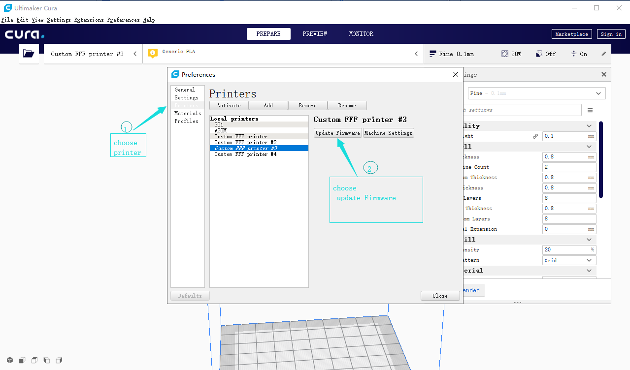

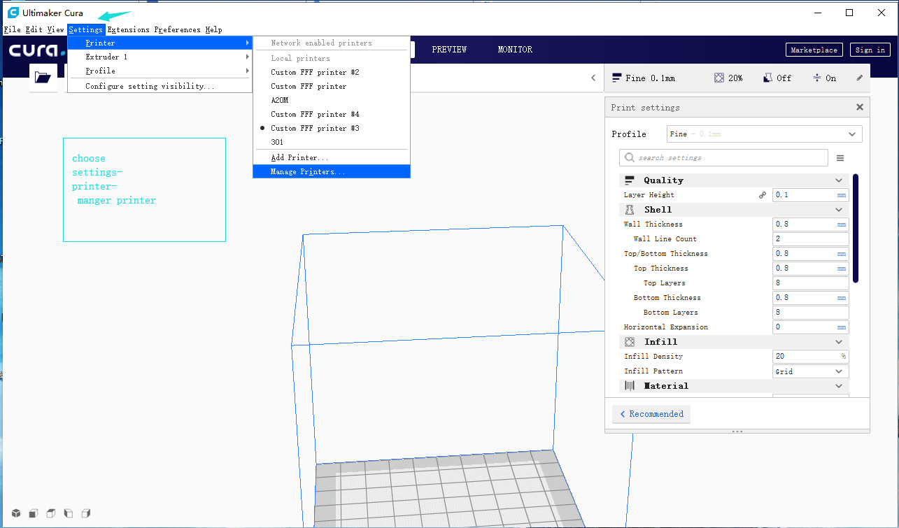

Hi, Are you referring to the white screen on the printer screen after refreshing the firmware?
Can you use CURA,
if you can, you can go to the official website to download the compiled HEX format file.
:https://www.geeetech.com/download.html?download_id=35
Then select in the Settings-printer-manger printer
Select update fw
If there is still a problem, can you provide a specific video?
So that we can solve the problem better.
