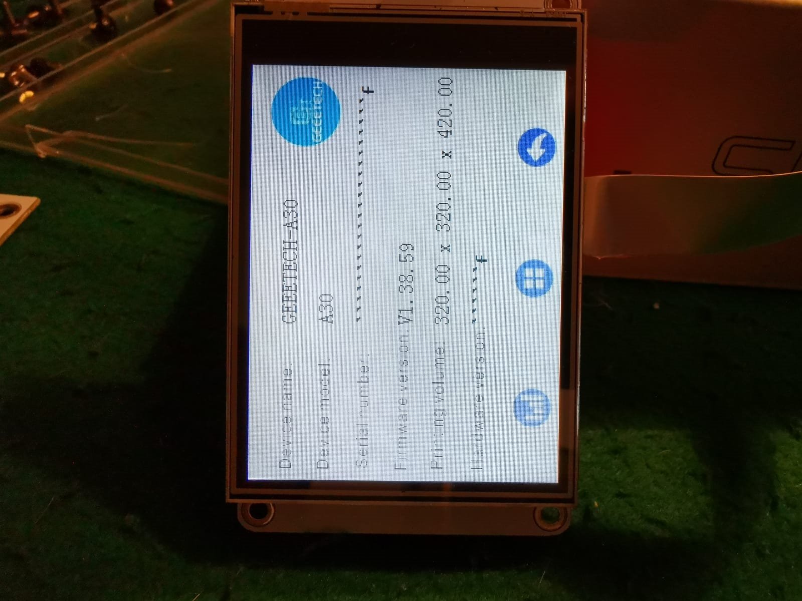

Hello everyone. I have this problem. I had to replace the MB GT32 MiniS, but now the serial number and hardware version are no longer available. I have recorded the data (serial and Hardware V) .... is there a way to insert them on the card?

Thanks, the MB is specific to my printer. In fact the printer now works. The only oddity is that I do not have these two information on display.

This situation is caused by the motherboard firmware and screen firmware mismatch, so some information can not be displayed

You need to update both the motherboard application and the screen application
