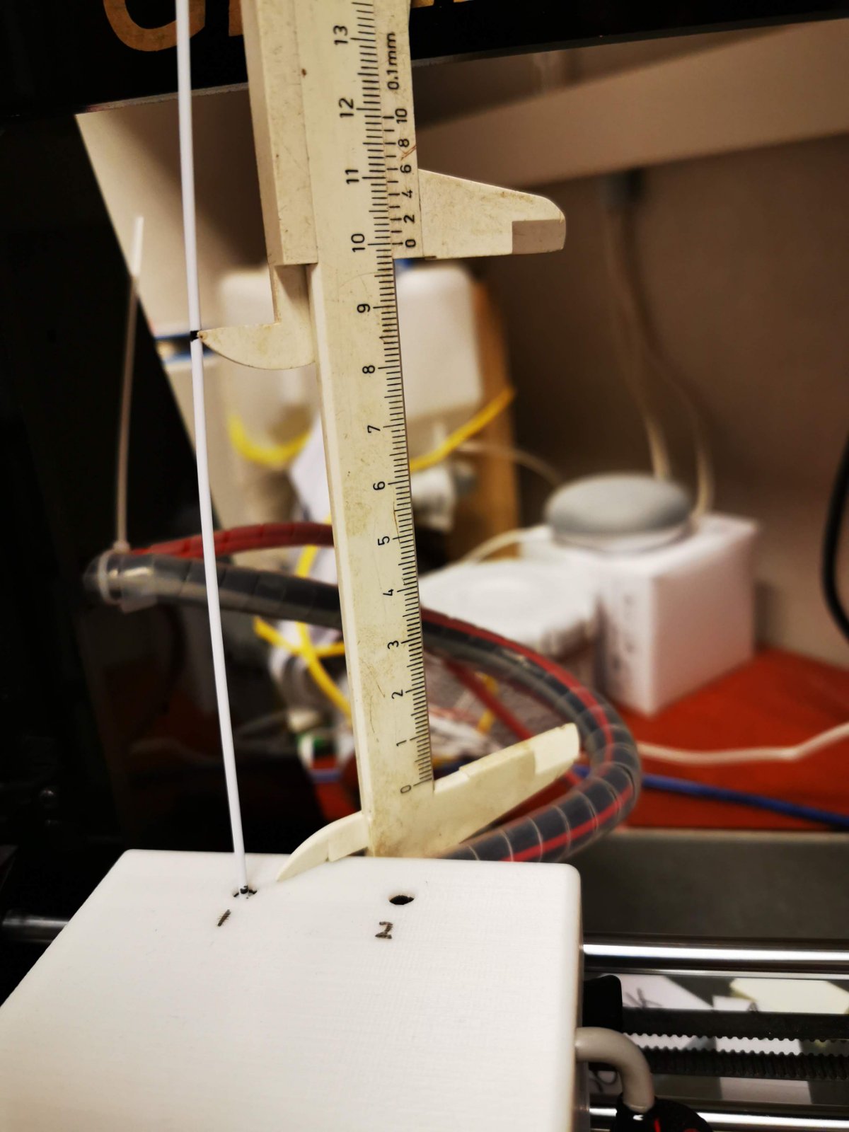

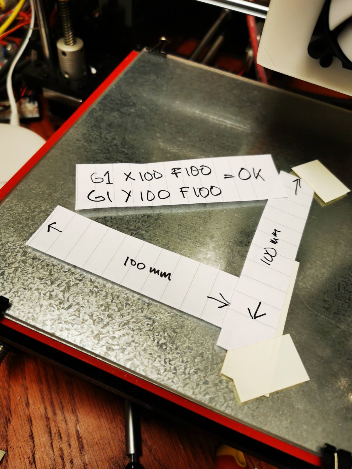

as you can see in the picture, If first send G91 and then G1 X100 F100 or G1 Y100 F100 to my X or Y axis, they move 100mm in 60 Sec
but if I send G1 E100 F100 to my printer, it Extrude 100mm filament, but in 27sec ?! how do I calibrate the speed of E ?
The length is right, it extrude exact 100mm, but the speed of the extruder is much to fast !!!
And! if I send M221 S50 To get 50% Speed, my X and Y Axis Moves 100mm in 120 sec = OK
but if I the send G1 E100 F100, it extrudes in the same rocket speed , but only 50mm ?
