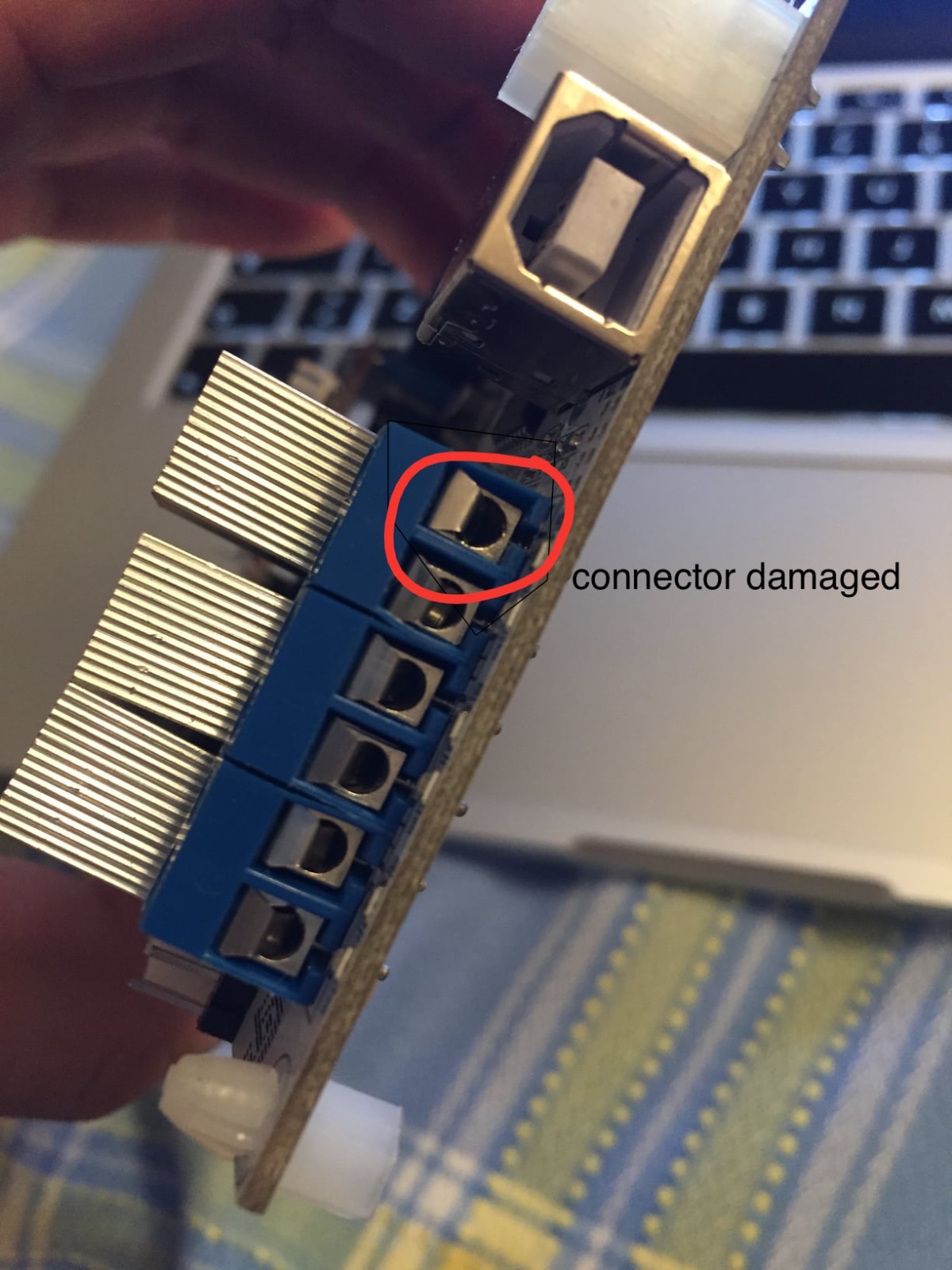

I have noticed that the control board that came in my order has a problem with the hot bed connector. The latch of the connector is broken and does not tighten, so it is not possible to connect the power cables to the hot bed.

here post the image of the connector damaged

Are there no screws to tighten and fix the heating wire?

As Gingko suggests, this is a screw connection.
Plug the uninsulated end of the cable into the hole. Tighten the clamping screw from above.

The screw is inside, but it does not tighten, no matter how many turns I give it, it seems that the screw thread is defective.

It could have happened as you say.
In this case, the entire socket must be replaced.
If you want to do it yourself, you need to know the lead raster.
For this purpose, the leg distance can be measured with a calliper.

I have no experience repairing control board connectors, so I think it would be best if you give me another solution.
I would not want to cause more damage to the board when trying to repair the connector.

Consult your salesman. Tell him about the problem.
