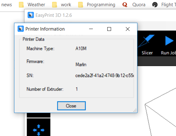

Hi I have checked the wiring
into the main board up to the extruders from plug to plug all looks ok
I then swapped the leads over between motors E0 and E1 and the E1 motor works fine
The easyprint software shows only 1 extruder after connecting to printer and Using Alt P (pic attached)
I suspect one of the following
1/ firmware ?
2/ Motor Driver ? How to test?
3/ Main board ?
Any suggestions on which course to follow first

Have tried to update firmware (successfully) same result ver 1.1.8
in axis menu only shows extruder not extruders About printer only shows extruders :1
so that leaves
2/ motor driver ?
3/ main Board ?
so that leaves
2/ motor driver ?
3/ main Board ?

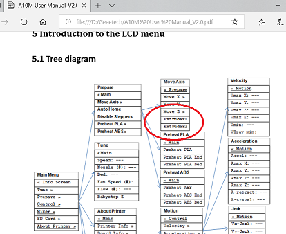

The attached image of the manual shows extruder 1/ extruder 2
I only get Extruder under the axis menu tree ???
So i cant test feed any filament
