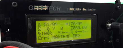

LCD:ERROR:MAX TEMP OR ERROR:MIN TEMP
01
01
01 MAX MIN TEMP.jpg (90.18 KiB) Viewed 89056 times

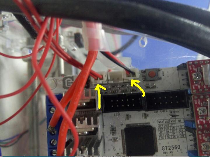

Above of all,check the wiring of thermistors if you have a single extruder on your printer.The right one should be like this:
Recommended solutions:

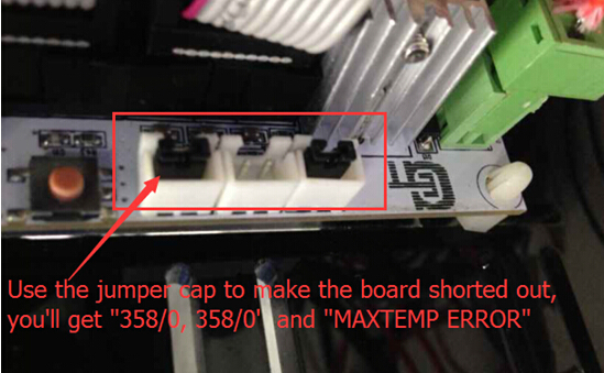

1.1 First, check the motherboard. If you get 0℃ and 358 ℃ when you make the thermistor open circuit or short, then the board is good. You can do it as follows.
Note: If your printer is Delta G2/G2S series, before checking this please install the firmware for I3X or I3 pro C, cause when you short out the thermistors with the firmware of G2/G2S, it will always show 0 degrees on the LCD, though it is exactly MAX temp error.

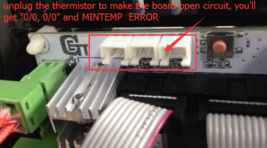

Open circuit:
open circuit01

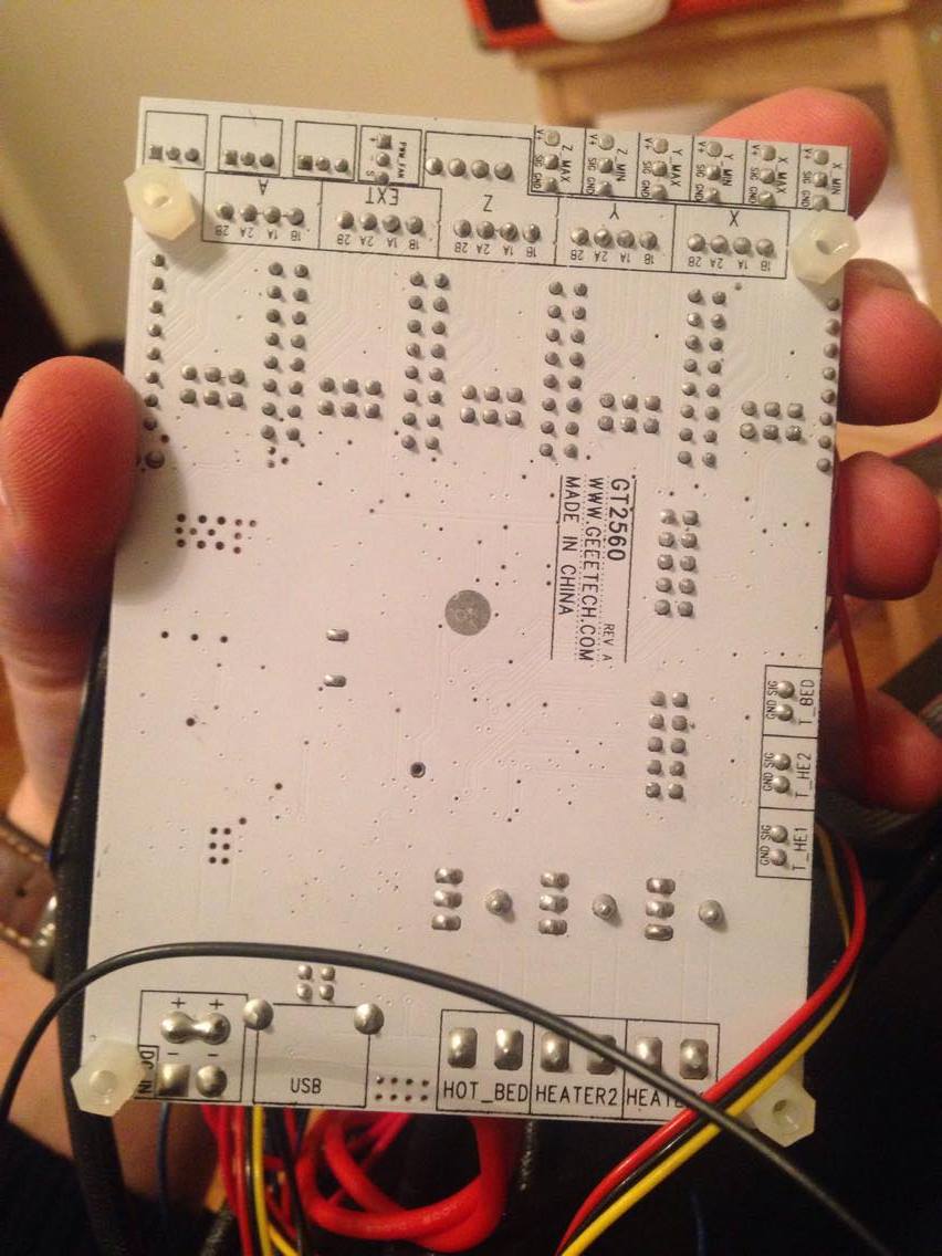

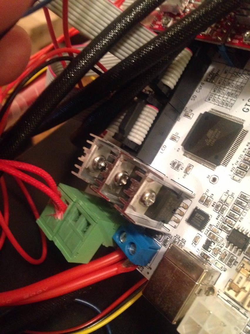

Short the board:
short01
short01
short02
short02

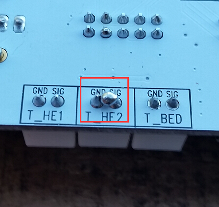

For example,the T_HE2 is shorted out.As a result,the second extruder will always display 358/0 no matter you make it open circuit or short circuit.

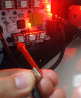

1.2 If the board is OK, please check if somewhere of the wire are connected or not.
For example, the thermistor is shorted out as the picture shows:
05
05
If so, the current will not go through thermistor, and LCD will display TEMP ERROR. You can refer to the following information:

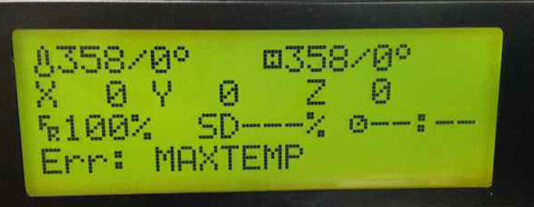

MAXTEMP ERROR:
1.2.1 If it shows "358/0, room temp/0; Err: MAXTEMP". The extruder thermistor is short.
1.2.2 If it shows "358/0, 358/0; Err: MAXTEMP". Both extruder thermistor and hot bed thermistor are short.
1.2.3 If it shows "room temp/0, 358/0; Err: MAXTEMP BED". The hot bed thermistor is short.
MINTEMP ERROR:
1.2.4 If it shows "0/0,room temp/0; Err: MINTEMP". The extruder thermistor is open circuit.
1.2.5 If it shows "0/0, 0/0; Err: MINTEMP". Both extruder thermistor and hot bed thermistor are open circuit.
1.2.6 If it shows "room temp/0, 0/0; Err:MINTEMP BED". The hot bed thermistor is open circuit.
NOTE: Remember to reset the LCD after you do those experiments. And the MAXTEMP shows in the LCD is not always 385, it’s between 358 and the temperature you set in the firmware here:

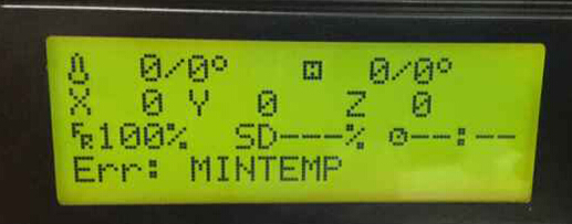

hi guys,
i am having the same mintemp problem and i think that is everything good connected. on my lcd display it only shows "0/0,room temp/0; Err: MINTEMP".
is something wrong on the pictures ?
thanks

Did you try placing one jumper cap to the socket(to verify if the socket was broken) for the thermistor of extruder0?
Or you can plug the thermistor of heatbed to that socket then see how it shows on LCD,you can get the outcome(the socket or the thermistor itself was broken) as per that.

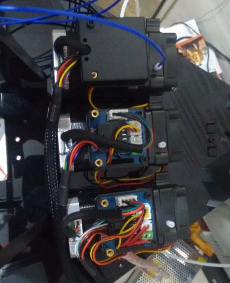

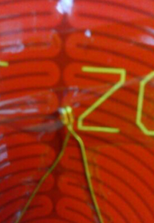

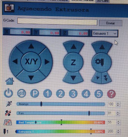

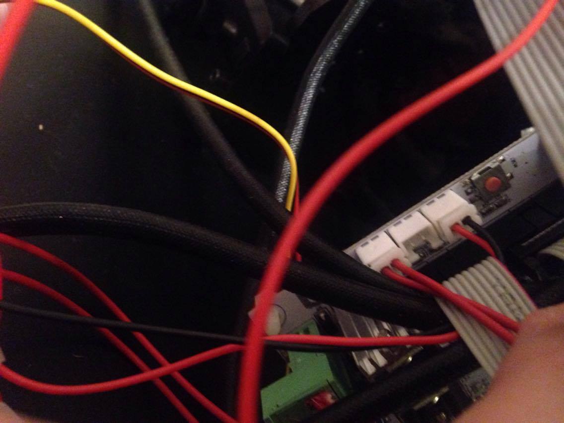

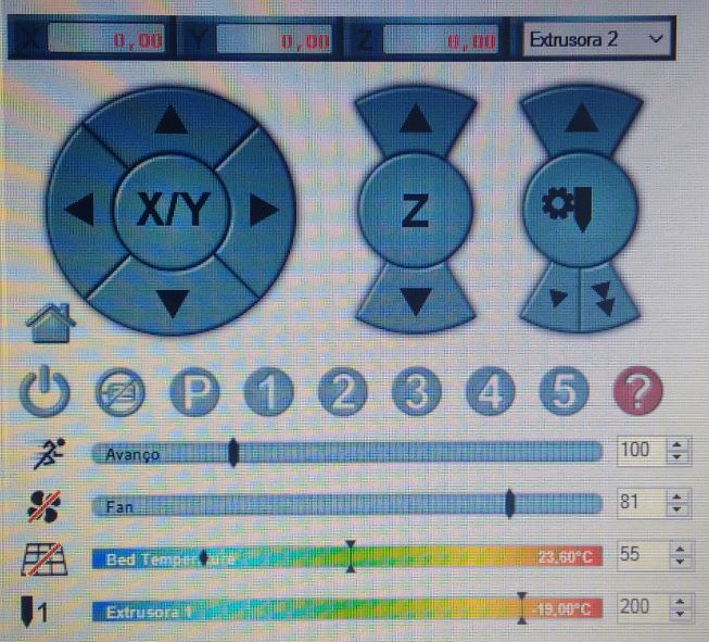

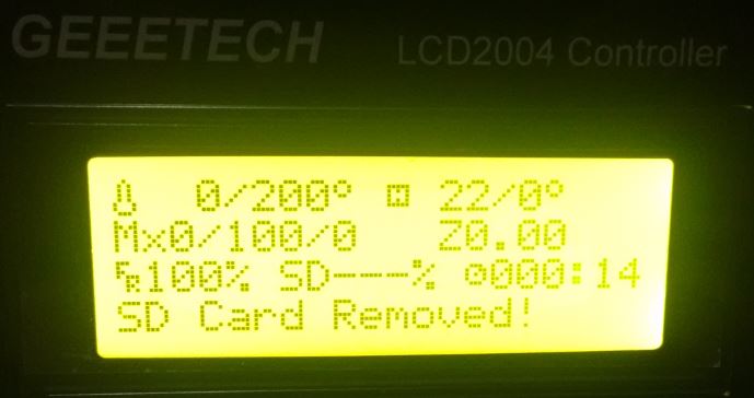

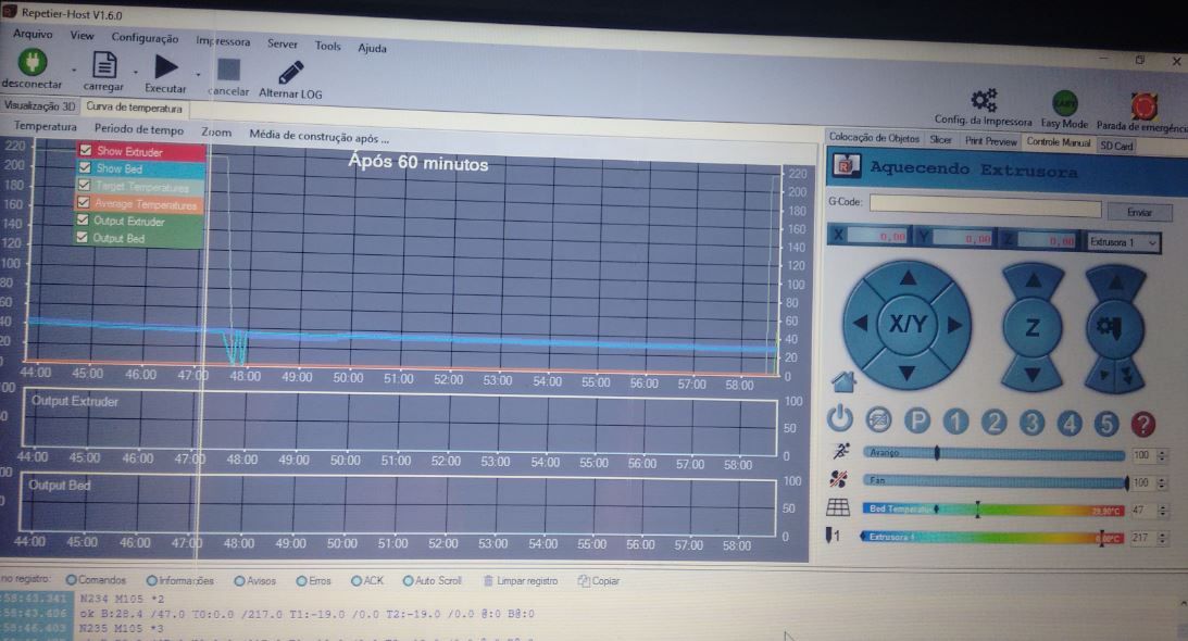

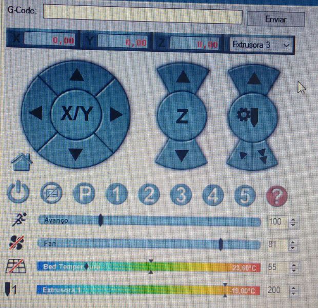

Personally, I bought the Rostock 301 printer, I have a problem in the Extruder and in the extruder that is not heated, the LCD always shows 0 / 0º. I think it may be some printer setup, can anyone help me ??
I tried to contact the company by email and skype but, so far, does not receive any response.
Attached photos.
Please help me.
Ats
Jean Braga

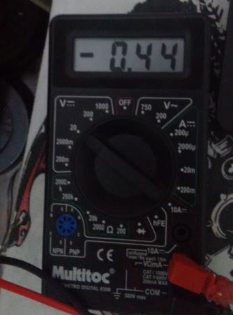

With a multimeter I measured the purple-gray and yellow-brown extruder cables with 630 and 612 ohms with an ambient temperature of 20º.
I have also measured the blue and green wires of the bed, without getting any value.
What is happening? How do I solve this problem?
