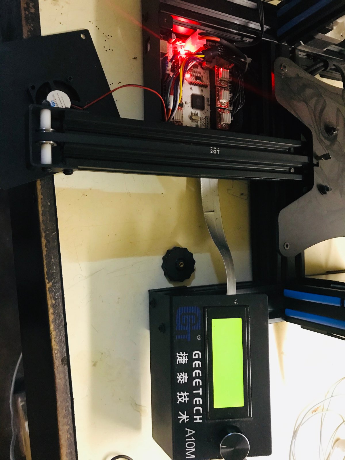

Hi. It was after a long print of around 25 hours. and the printer was kept powered for another 6-7 hours even after the print was finished.
After switched on again it was okay for few minutes (until the hot-end pre heated) and suddenly the text on the display were disappearing and shown very very light black. after some time the display started dimming and brightning. when switched off and switch on back, the display shows the ' merlin 1.1.8 ' message and then its full green, no text. still some dimming occurs and some time later turns itself off. the fans are working. the lights of the mother board are lightning. the voltage output of the power supply is 24v and around 24v all the time. Please help me to figure this out. Thank you in advance!

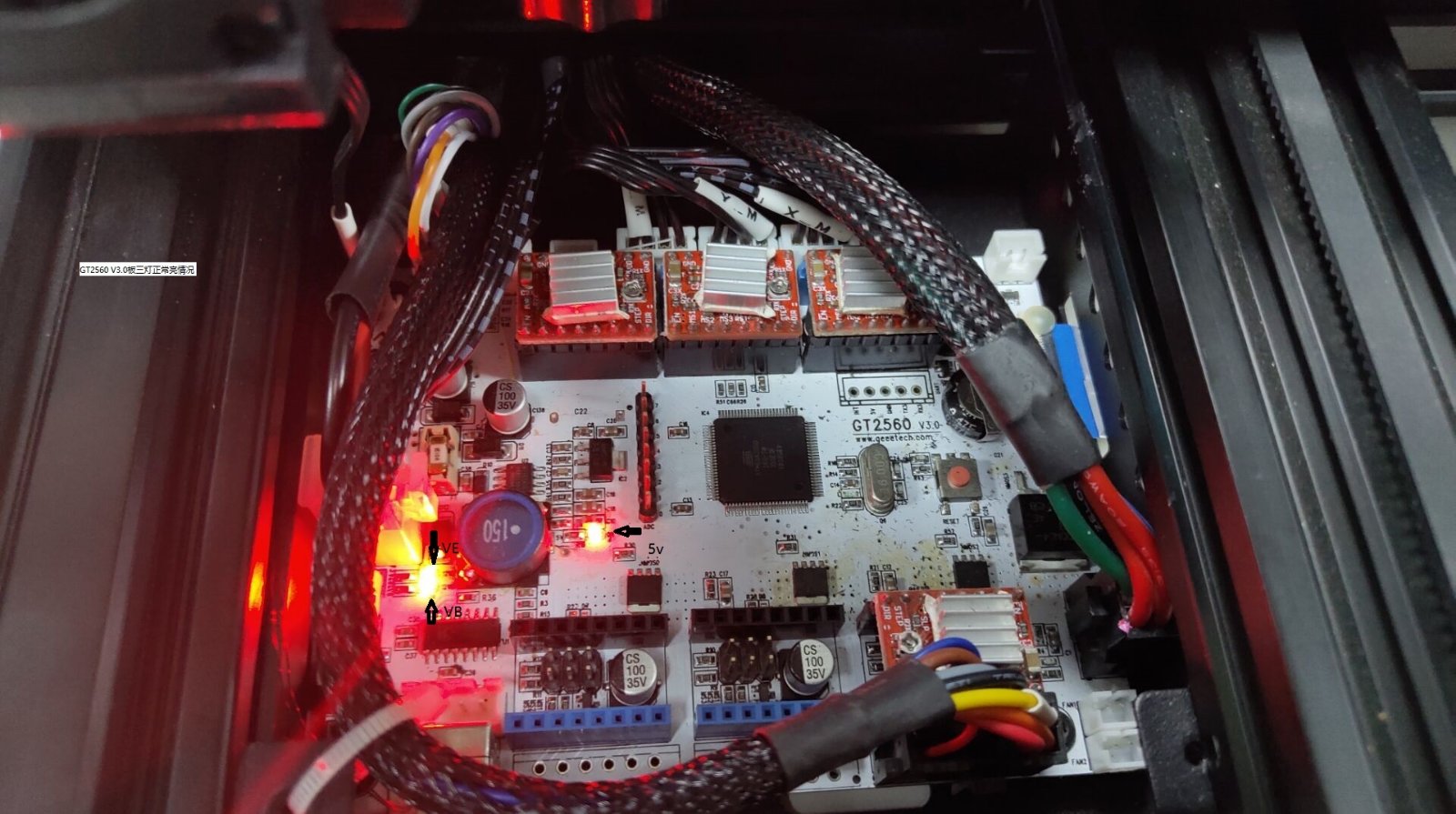

Hi, You can
1. Reconnect the screen cable;
2. Check if there are three lights on the motherboard when the printer is turned on normally. You can refer to this:

@williams. thank you verymuch for your reply. I re connected the display's connector. I will check the bulbs of the mother board now. How can we know the mother board is good or gone? I tried to re upload the firmware but it didnt get uploaded
Re: A10M display is green. No text is shown
Hi, If it is normal, the vb ve 5v light will be on the motherboard.damith wrote: Thu Aug 29, 2019 1:39 pm @williams. thank you verymuch for your reply. I re connected the display's connector. I will check the bulbs of the mother board now. How can we know the mother board is good or gone? I tried to re upload the firmware but it didnt get uploaded
If one of them is not lit, the motherboard may have a problem and need to be replaced.

Hi, I have the same problem. Display is green no text and also USB connection is not detected by P.C.
The printer was working fine before this with no issues. However when I shifted residence I had dismantled and reinstalled when there was a pop sound on restarting. Then I noticed one of the cable was wrongly connected and I fixed that.
However now I have this green display and non-functional USB port. I have not made any changes on the board and the the three red leds are lit. . Checked the ribbon cable connections they are fine. Power is also available on the display unit(4.9V).
Please let me know if need to check anything and guide me to get my A10M working again.
