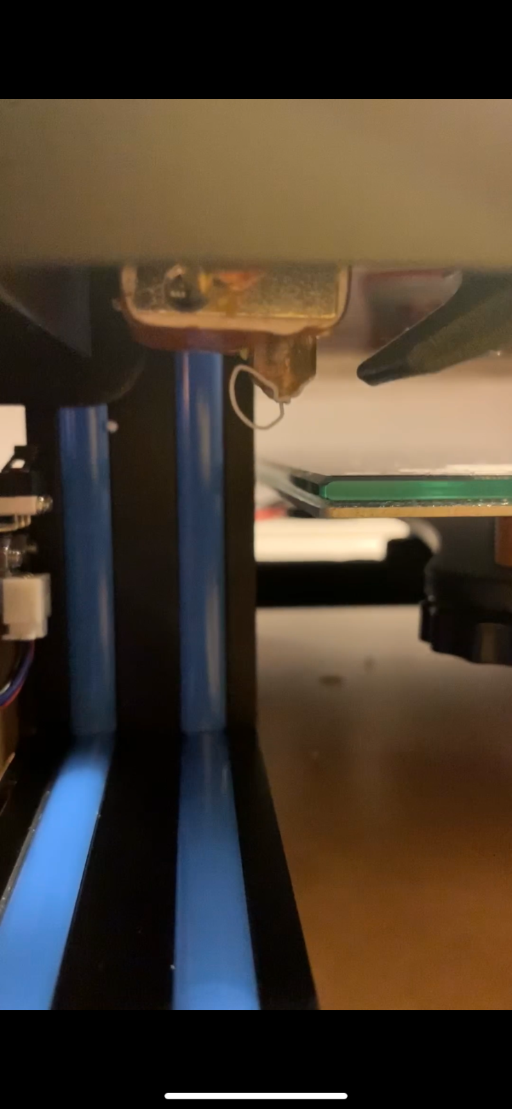

next issue is if i start printing the nozzle heats up. at 160-170° the filament starts to poor out of the nozzle. Coauses a long tail of cold filment while traveling to start position. The cold filament want stick to the plate an causes a failed print every time. i dont know how to fix this.

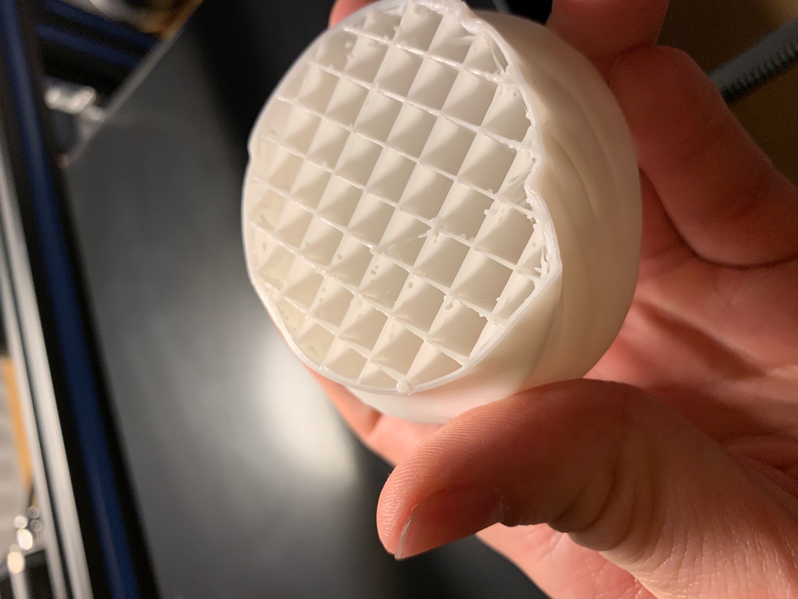

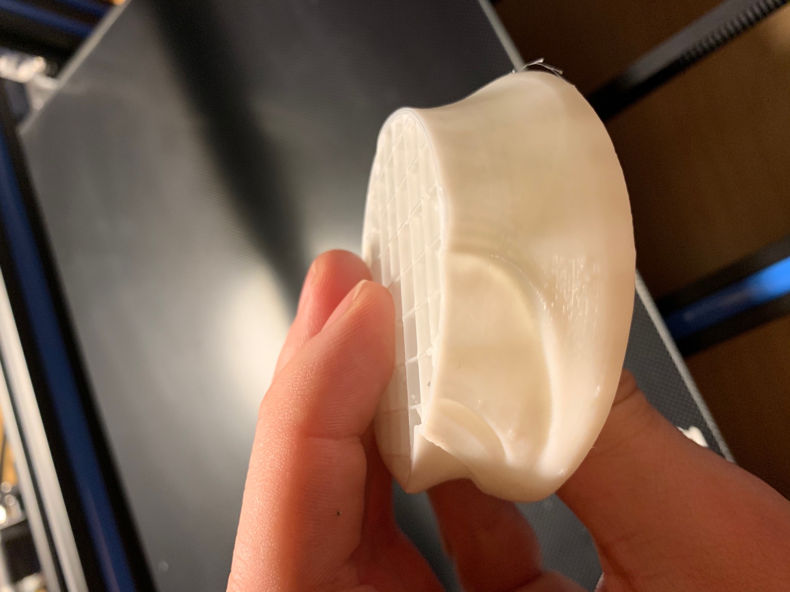

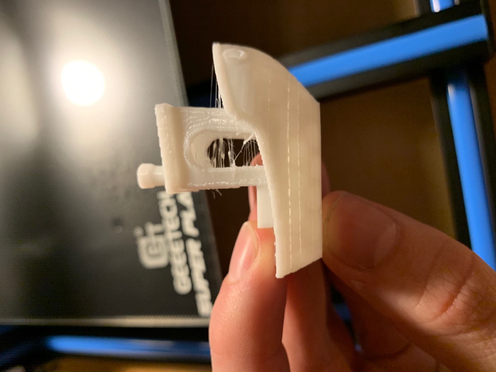

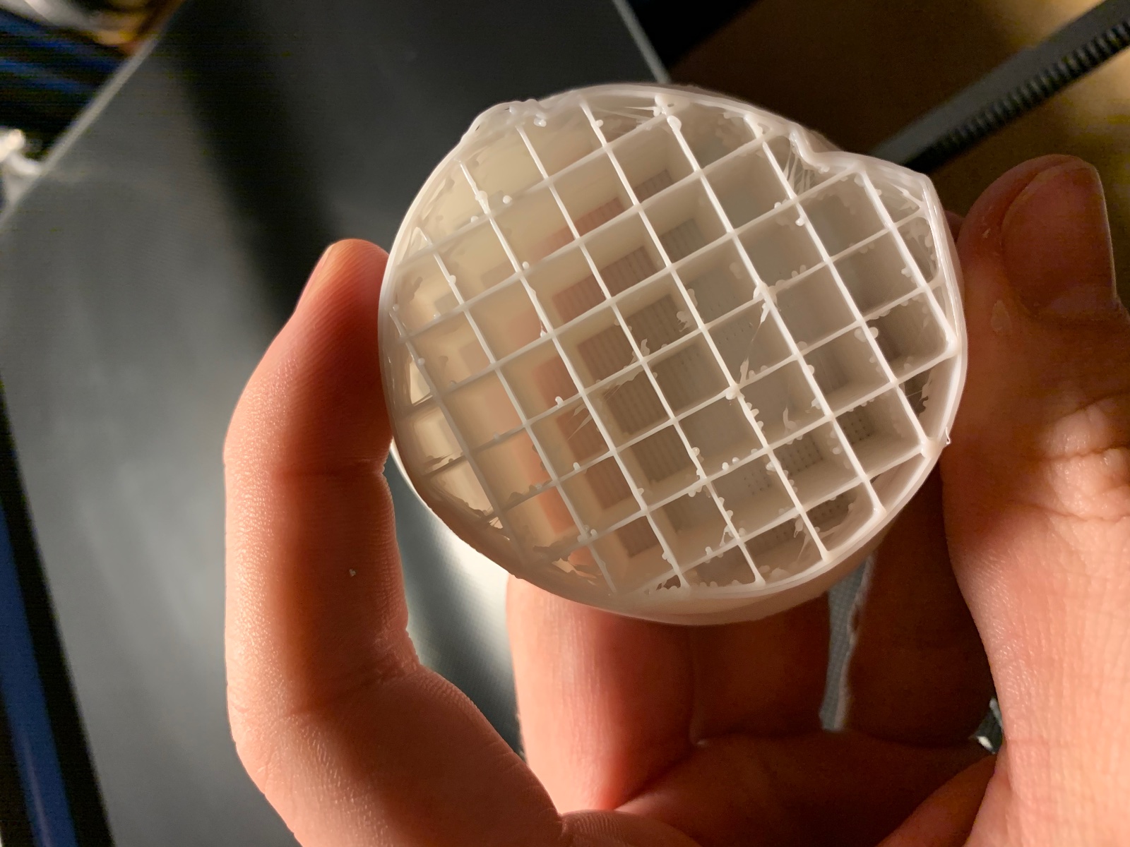

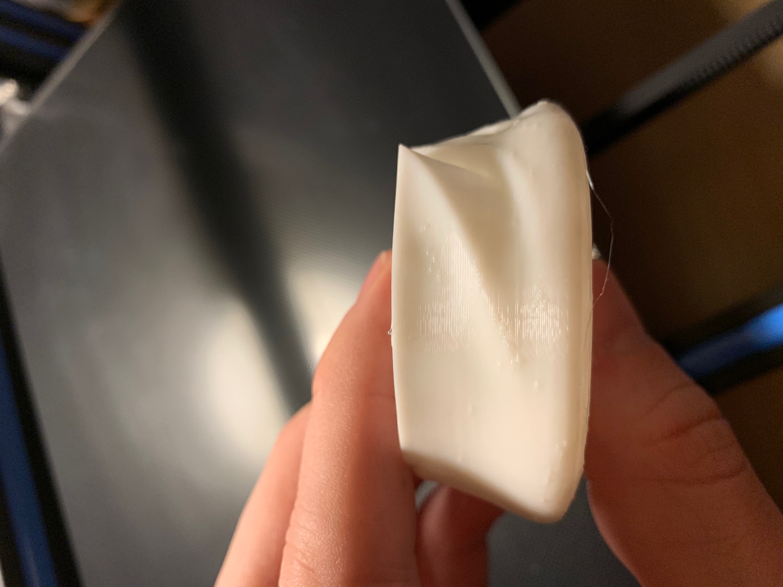

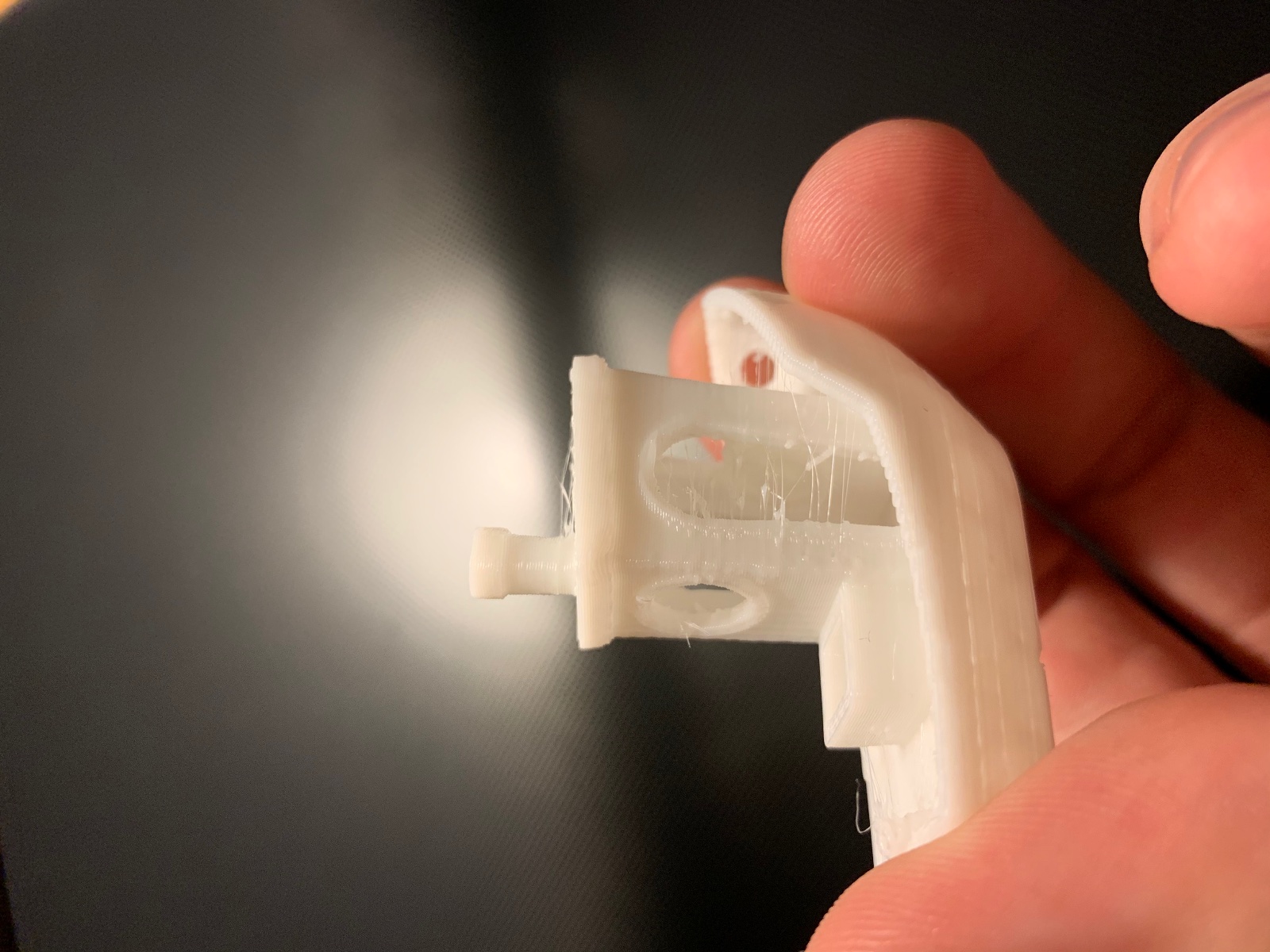

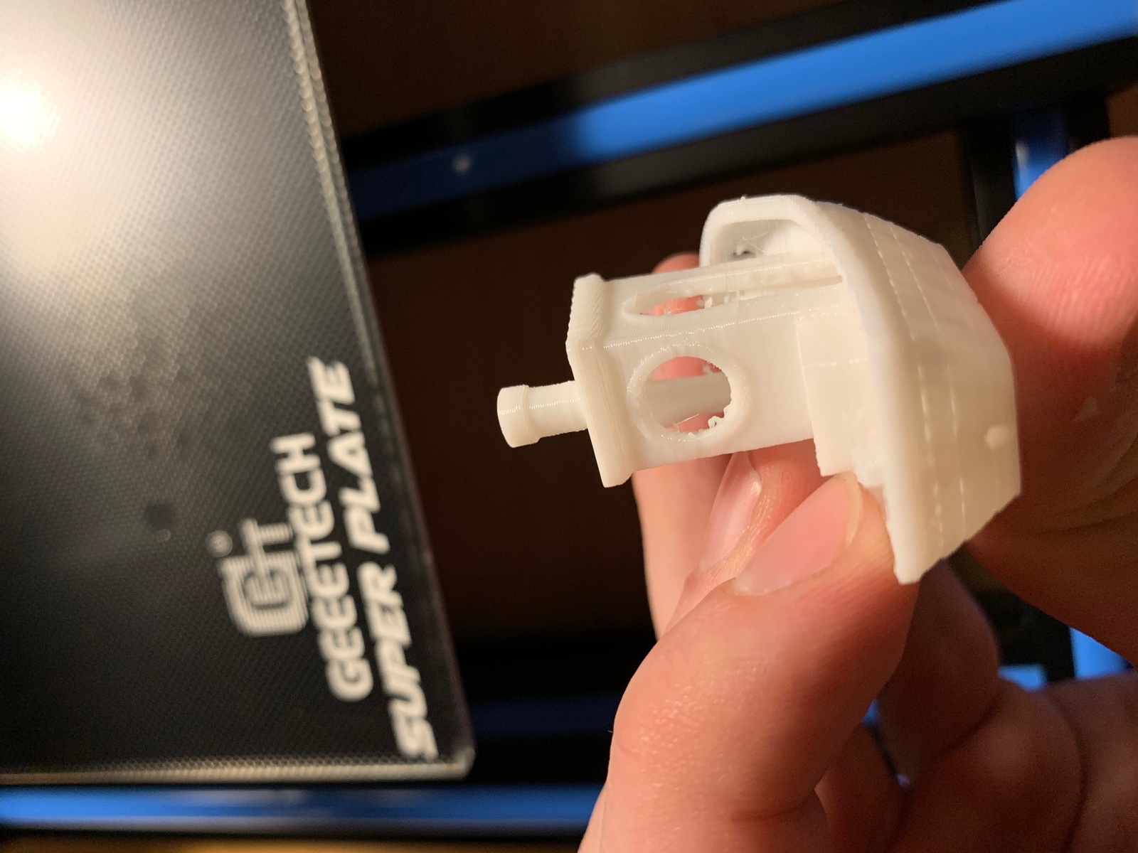

One of the pictures shows the problem i discribed. The oozing nozzle before the print starts.
I managed to manual fix this problem. Before print I heated up the nozzle in that manual mode than pushed pla through and than let the printer pull it back.Than started printing with an outline.
After half of the outline the filament starts to came out of the nozzle and sticked on the bed.
I printed a boat and half of the testprint(not enough time sadly).
Temp was on 210 and the bed on 50.
