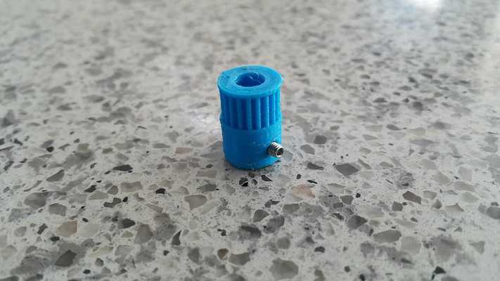

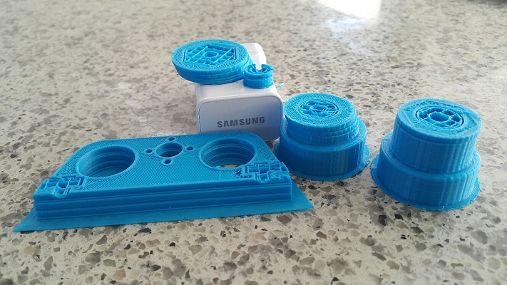

I've had this nagging issue of random "Y" axis shifts in layers as this picture shows
I did the obvious and tinkered with the V-REF of the motor driver and put a much bigger fan over the drivers for cooling but I was still getting the odd "Y axis slip. I'd feel the motor and it was relatively cool so it was obviously something else.
The when trying to print a 20T GT2 pulley it was failing every time (its in the pic above) and I'd hear a mechanical "clunk!" when it failed. I then remembered seeing in the RepRap troubleshooting guide for shifted layers that motion settings can cause this problem, (RepRap Guide here https://reprap.org/wiki/Shifted_layers)
There was some recommended speeds to try which were much much lower than in my setup so I tried them and hey presto it worked and printed the pulley.
It was very slow compared to what I had previously but at least I have the answer now and I can experiment till I find that happy compromise

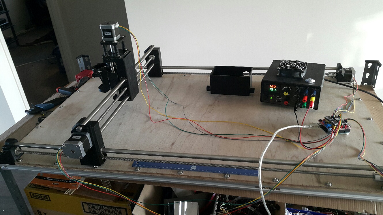

It's all fun and learning the design and then digital manufacture give a sense of achievement. The main parts I'm printing at the moment are for a CNC Engraver I'm building. I've got the "Digital Build Bug!" I also recently made an Arduino Indexer that I can attach to my Lathe and ultimately my Mill. That's what the 20T GT2 pulley was for.
