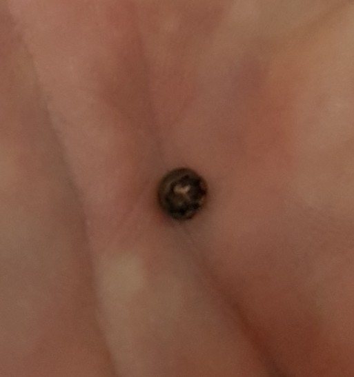

I've found in the forum there was ring in the hot end, I decide to dismount it and look inside. My 2 laines are not the same ! In one, I found a cooper piece and in the other a silicone? ring.
Remove them does anything, print are realy awfull ...

My controler card seems to be a new version (marked as 3.1), no firmware specific for this card, I used github and Vert's to test -> same thing.
I've read the FAQ here : viewtopic.php?f=108&t=61882 :
  • My ptfe tube is correctly insert, about 3.5 cm in the hotend.
  • I've clean my hotend according to the procedure
  • The extruder spring seem's to be OK
For me, ther is 2 options, as the problem seems to be about the hotend :
  • Bad thermistor (will check resistance today) or misfconfig in Marlin ? I use type 1 as thermistor in Marlin. Maybee it is another thermistor ?
  • Extruder problem : Like I say, the 2 tubes where I put the PTFE are not the same inside :
In the left one, I found this piece of cooper :
In the other, a sort off plastic ring, or maybe PLA ? (I've no photo for this, sorry)
I've remove both, changed the nozzle, same result, to low temperature and under extrusion, the extruder is ripping.

William wrote: Wed Nov 13, 2019 9:16 am Hi, I find this:https://github.com/caesar1111/Geeetech- ... UGLLw0IqLw
Thank you William,
That is what I've made expect some parts (I did not seal the throat with silicon)
And effectivelly, my hotend is not complete If you look a the first image, there is 2 cooper screens, I only have one... I'll try with the support to have new hroat

It is really strange, before update I can print at 190°C without any problem.
Now at 240 °C I have problems to print (same PLA)
Did someone know where to buy only 2 throat with the cooper screen ? (like photo here :https://github.com/caesar1111/Geeetech- ... is-melting )
I did not find any spare parts except complete hotend, I am wrong ?
