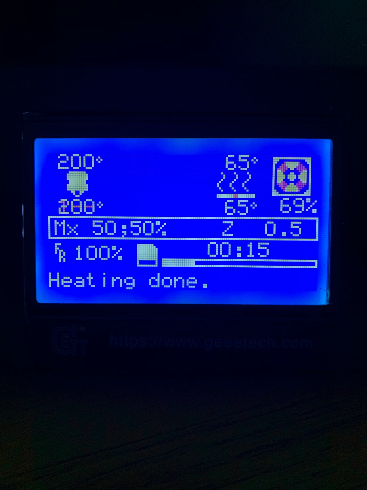

Hi James,
To confirm the A20M has ONE Hotend and TWO Extruders (E0 and E1) - for anyone unfamiliar with this printer.
Having exactly the same issue - unless I'm being really thick, I get the following problem:
a] I find a 2 colour example stl file - it has 2 clearly defined colour segments with NO graduation between the two colours
b] I load these (2) files into Cura (with A20M profile already loaded in)
c] I then assign a colour to the respective segments and merged the print
d] This I then sliced
e] Saved as GCODE ready for print
f] (only did this in case I was going mad) I then open the GCODE file in text editor and search to make sure the "M163 E1 P1.00; Set Left to 100%
M163 E0 P0.00; Set Right to 0% M164 E1; Save Mix" commands don't say anything other than either 100% on or 100% off (so either E0 or E1 are exclusively in play at any specific time) - having checked the entire file, there is absolutely NO mention of anything else (so no 50/50 commands)
g] Save this fie onto SD card and pop into A20M SD card slot
h] Select the file for print and cross fingers
I] Printer switches randomly to 50/50 throughout print resulting in something that resembles a badly printed smudge. If I'm lucky, one colour might be 100%, but the second is a 50/50 mix....
Like you, pretty new to this perhaps, but I'm totally perplexed as to what else to do - there must ether be something wrong with 1.1.8 firmware or a command that needs to be sent to say NO DON'T MIX THE COLOURS just please print it as a solid 100%, like the GCODE told you to...
Will cross post this as its driving me insane
Fatumpch

- Example of A30M switching to 50/50 mix

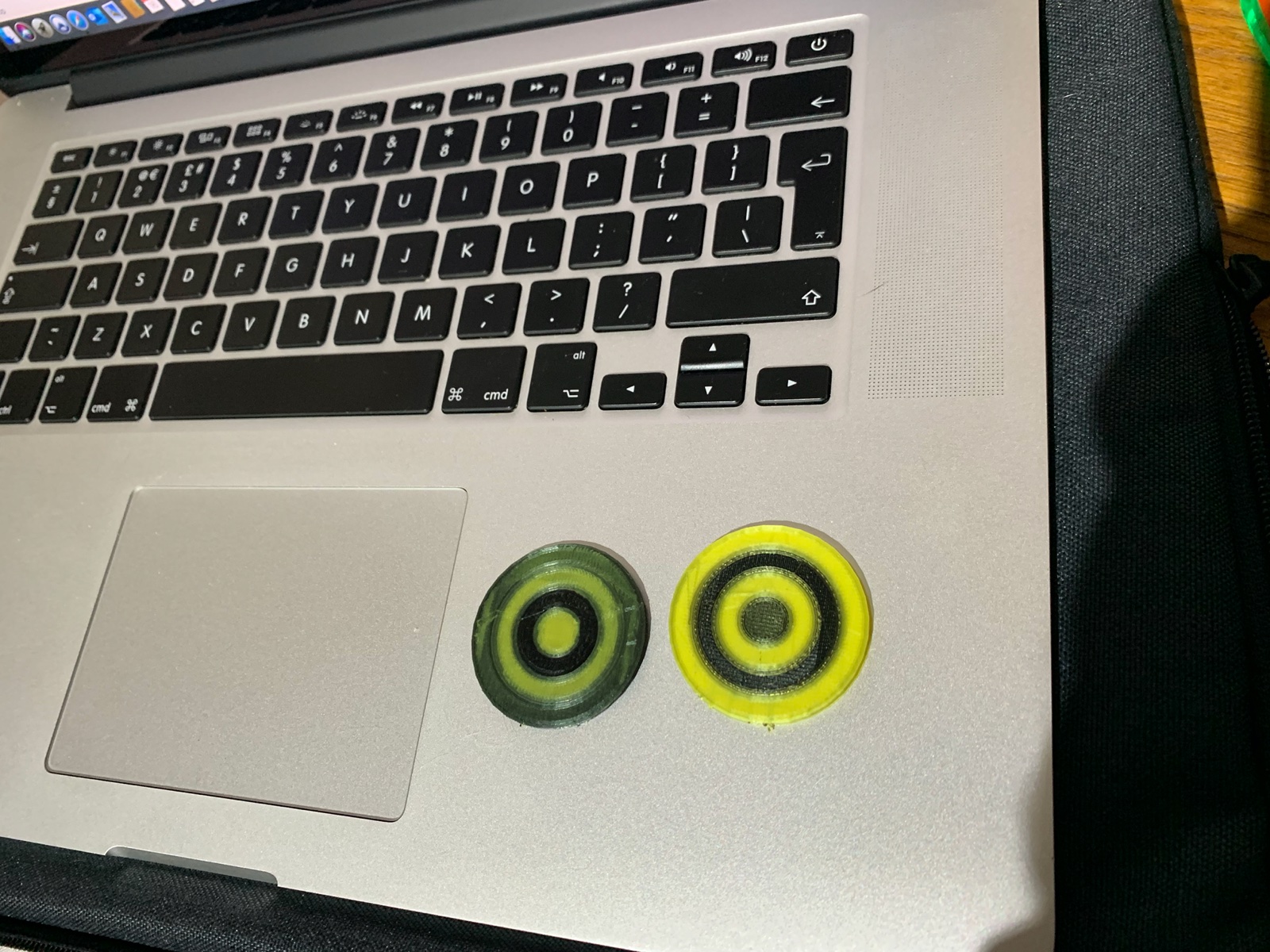

- Rubbish 2 colour results

Thanks for that - have been trying to get the script to work, but it almost seems that after a purge - the head returns to the print and is good for the first layer, on subsequent layers however the head grinds into the the print (black section especially) Stringing is present but I'm considering playing with temperature and flow rate to see what the sweet spot needs to be to reduce this as the yellow seems to have gone down really well in comparison.

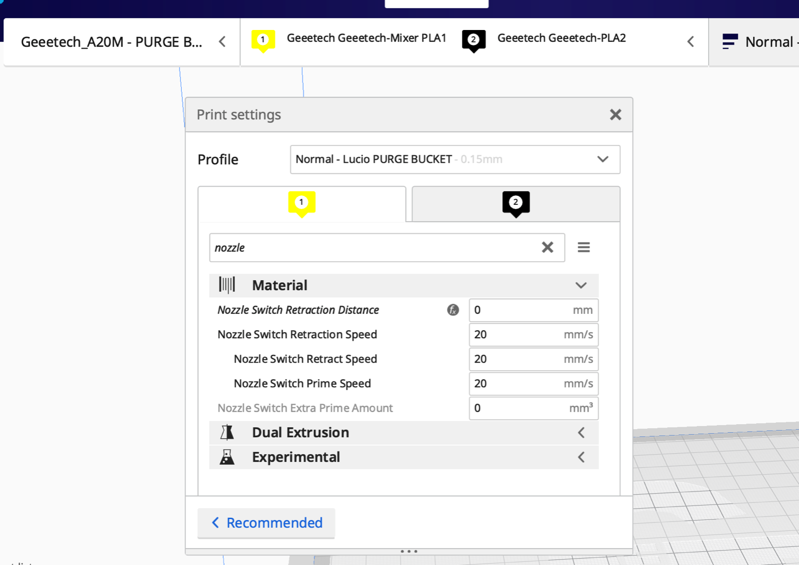

One thing I have noticed is the head tends to pause after the purge (after it travels past the silicone wiper) and a blob forms which seems to increase the stringing. I've adjusted the nozzle switch retraction to zero as advised (see picture) in the machine profile in Cura but left it at 6.5mm in the material profiles as I presumed the note referred to.
The end result (see picture) is better but the black PLA seems to bubble, whereas the yellow lays very smoothly... both are Geetech reels - am I missing something obvious?
