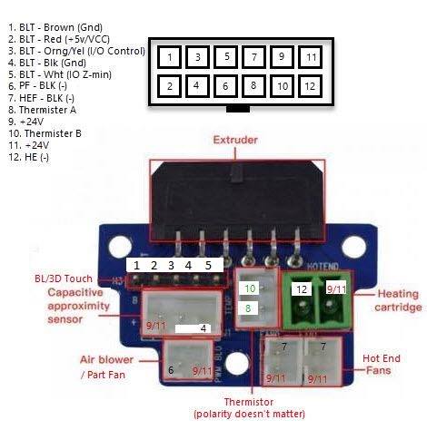

Using the below images, I cut the connector off the control-board end of the hotend bundle.
I'm don't have the 3d touch connected yet but I've confirmed I've got motion control, heating and fans.
I've crimped on JST connectors for leads that needed them.
Pin -> Board Connection
6 -> I
7 -> H
8 -> D
9 -> H
10 -> D
11 -> C
12 -> C
Jumpers are reconfigured for the A4988s I already had from the original hardware. Steppers are connected as labeled.
I did a diff between the example A10 Configuration.h and Configuration_adv.h and the default and copied over any values pertaining to the steppers, bed dimensions, etc. since I didn't change those out. All motion axes were reversed versus the default Marlin distributed by BigTreeTech's GIT repo.
I commented out anything regarding stepper drivers - Marlin defaults to the A4988s I already had but the BigTreeTech file was set up for TMC2208s.
I'll need to get into the weeds with the board schematic to work out exactly which leads are which on the servo connector (expecting the Geeetech stuff to be in a standard RE: pin 1, gnd, etc. hasn't worked out). I'll need to do the same with the limit switches as I've found they're not just plug-and-play with the new board either, the 3.3v, 5v and gnd pins aren't as the SVR board would expect them and everything crashes when used as-is. Fortunately it seems that the board is (at least marginally) 5v tolerant so I haven't fried anything yet with my brief and abortive attempts so far.
I also need to redo the cable bundle for the heated bed but that mapping is less awkward since there's no extension board like there was on the hotend. The hotend cable actually has a different number of leads on the controller end than on the gantry end and the ones that do carry over don't run straight-through.

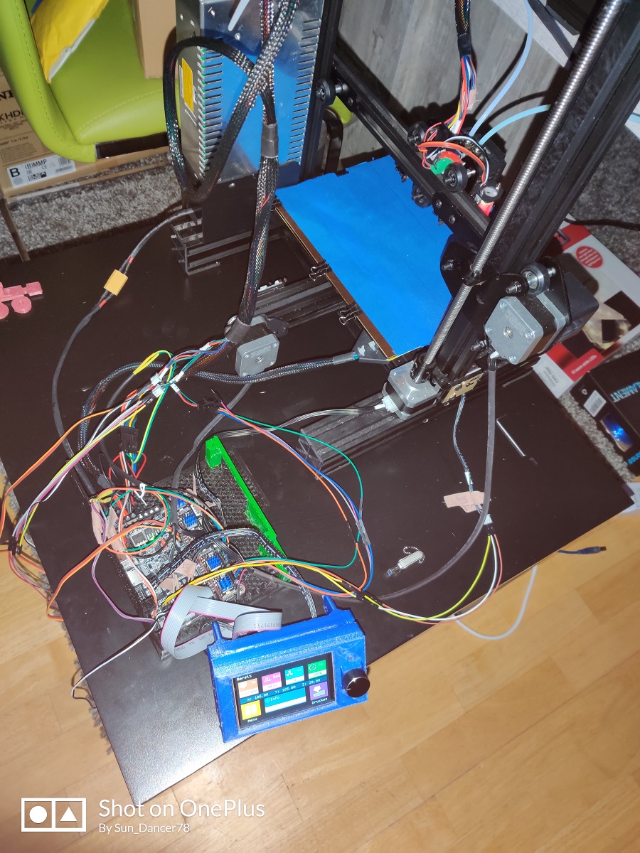

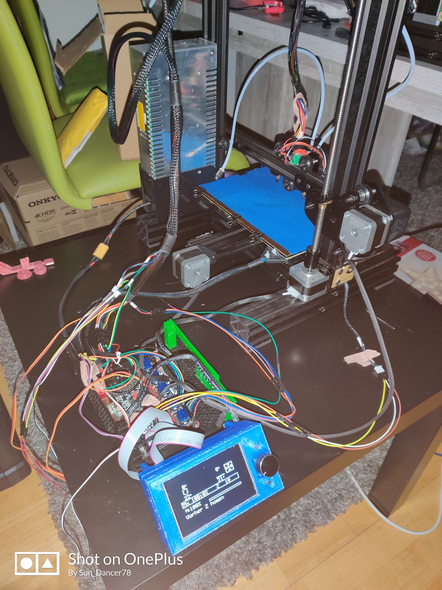

Hello, I am currently converting my A10M to a Bigtreetech SKR V1.3 + TMC2208 UART with TFT35 V3.0.
Everything is wired except for the filament sensors, which I will leave out until the board works properly. For now, I'll stick to the microswitches for the end stops.
now i'm ready that all axes run correctly, the endstops work, auto-homing, heating for bed and nozzle including thermistor. BL Touch works at least to the extent that the Senosr is addressed correctly. Somehow the needle on my sensor hangs from time to time, so I don't really get any further at the moment.
