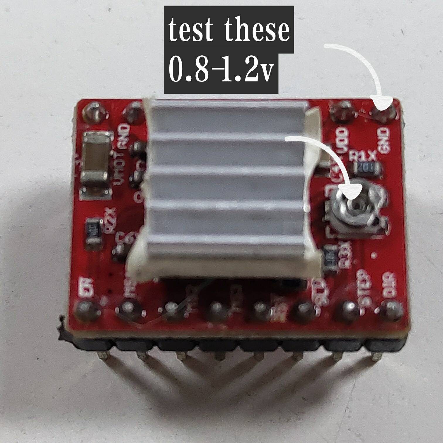

Hi, Can you provide specific videos?
You can try to swap the driver board,
or use a multimeter to measure the driver board. The voltage range is 0.8-1.2v.
you can refer to this: If your belt is loose, you can try to tighten it.

HI!... this A30M don´t have those drivers..
are you sure tell me what I must do....

I have read V in all drivers:
Motor E1: 1.333v
Motor E0: 1.306v
Motor Z1: 1.218v
Motor Z0: 1.160v
Motor Y: 1.318v
Motor X: 1.147V
do you think this is the problem?
Motor E1: 1.333v
Motor E0: 1.306v
Motor Z1: 1.218v
Motor Z0: 1.160v
Motor Y: 1.318v
Motor X: 1.147V

Hi,You can try to reduce the voltage properly,
