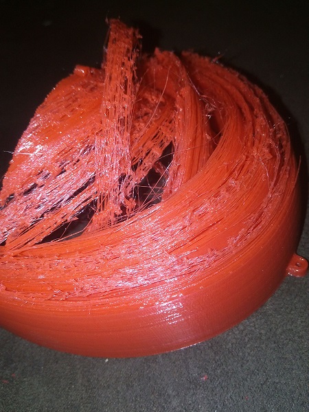

After trying abs I got my new roll of pla and descided to change back. After my few little small prints i descided to print the birdcage from SDCard. It started printing ok and towards the halfway it seems the material was thinning out. when doing a manual feed after heating the pla to 200c and pressing the feed in the repetier host the pla doesnt seem to just flow out and blundles around the print head sticking to it.
As you can see from the photo it started printing ok but then went bad.
First failure big failure after 3weeks.
- birdhouse fail

Maybe it was clogged after you changed the filament...have you cleared it?tassat01 wrote:HI there

When I tried another print after removing the filament whilst doing the first 2 laps before printing it progressive went thinner. What is the easiest way to unblock.

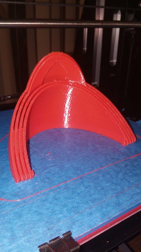

Re: BLocked extruder
thanks for the info, unblocking was a very painless thing to do.
One thing i will do is get a few spare extruders.
Heres the print of the same item. Looks way better
Hi,my friendtassat01 wrote:thanks for the info, unblocking was a very painless thing to do.
It's my great pleasure.Glad to see your perfect work

thanks, still working a few things out after another print, but i think it better to print at 100% than 300%
