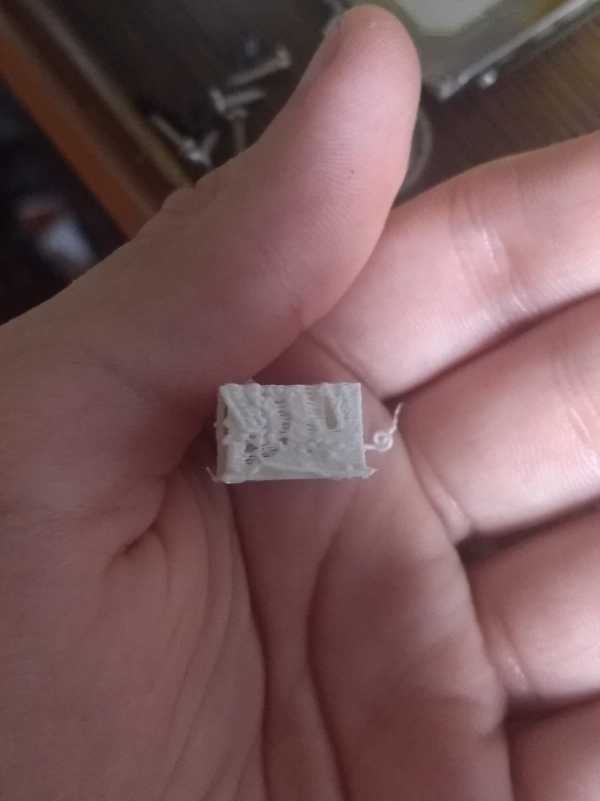

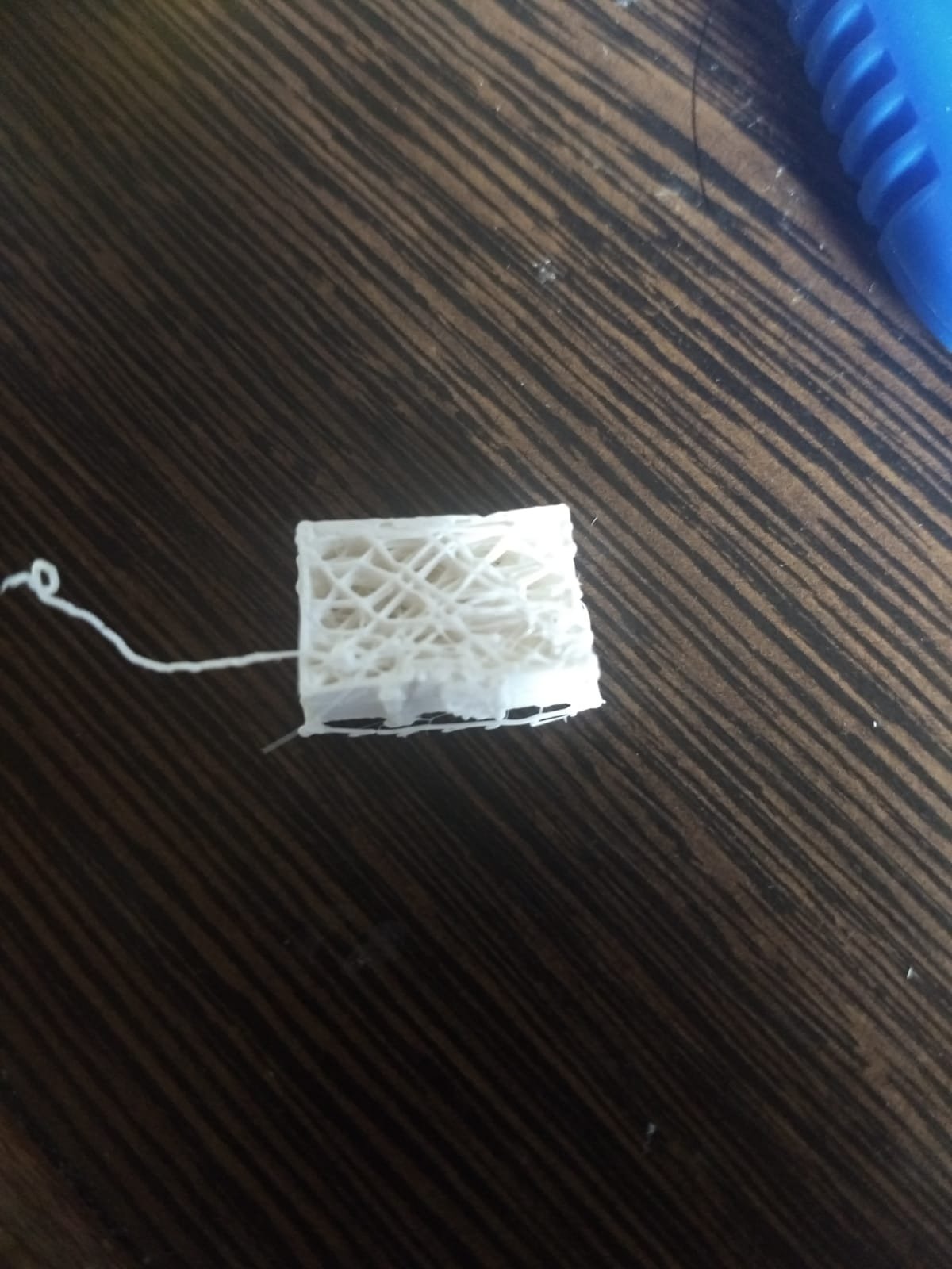

hello I have the prusa i3 pro b and I have layers shift in the Y axis, according to lei it is because of the print speeds so I would like to reduce the speed and try, Or does anyone know the solution to that problem? thanks

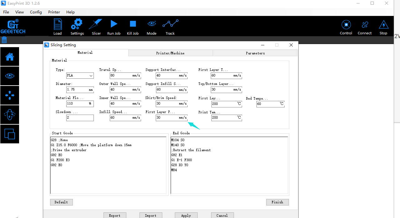

:D Hi, about layer movement,
You can check:
1. The tightness of the belt;
2. Whether the bearings and pulleys are issued with cards and lubricated with lubricants;
3. Whether the drive board voltage is in the normal range: 0.8-1.2V;
You can refer to the print speed adjustment in easyprint:

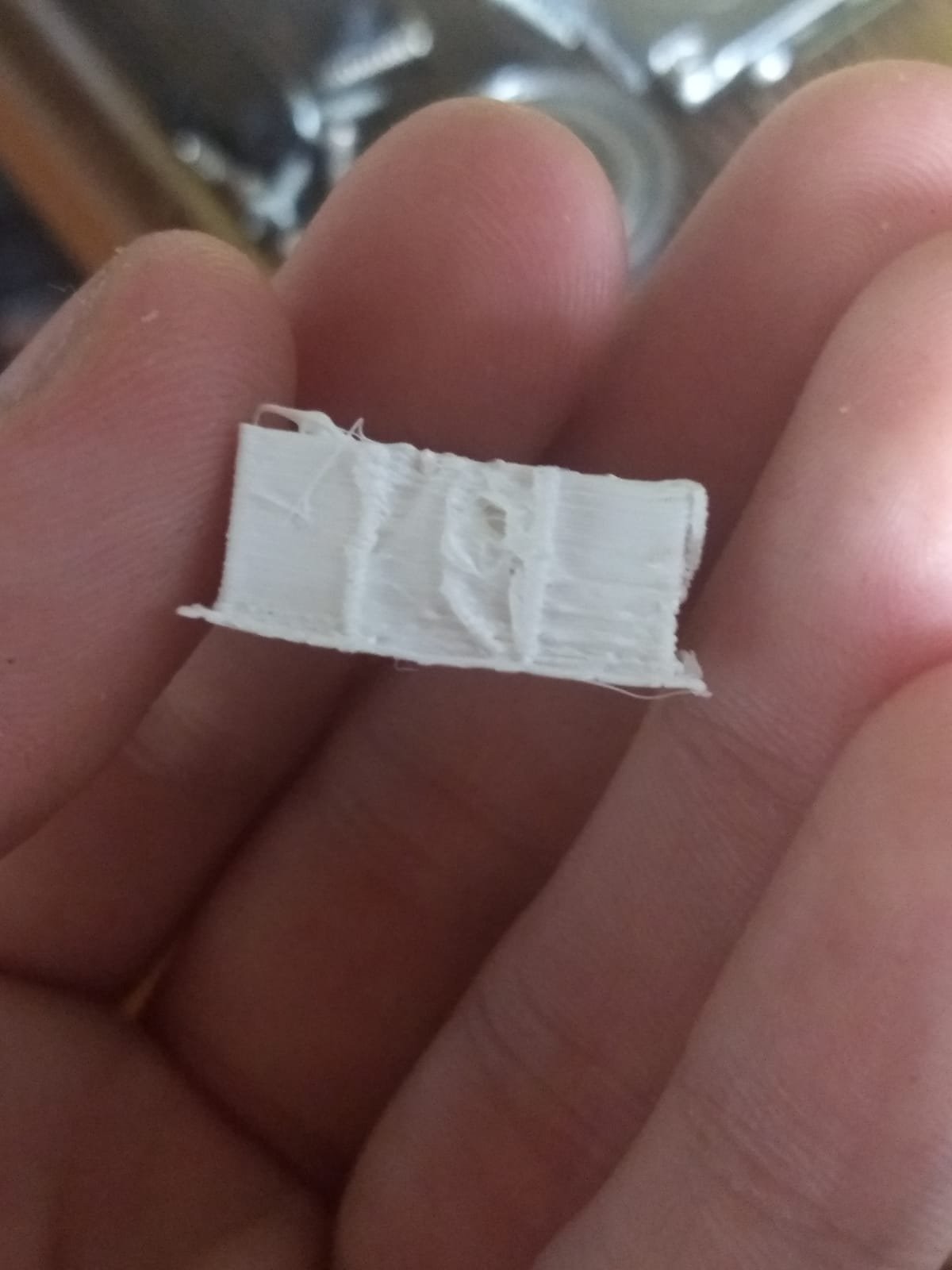

hello thank you very much I could solve the problem by copying your configuration, but I have another problem, I am printing the xyz cube and in the part of X it cuts a part and it is not a perfect cube

Hello Lukorely,
What tipe of filament you use?
Did you calibrate feed rate of filament?

I use PLA, I don't understand what you mean by speed, but that issue already solves it (the layer shift)
