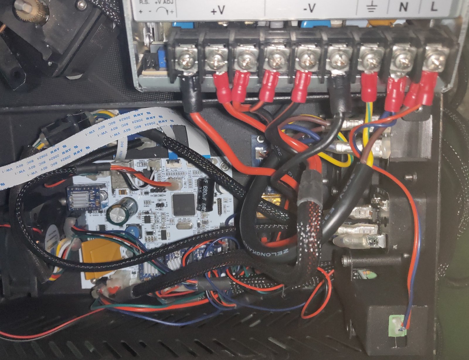

I have an A30 which i was taking apart (inside the control box) in order to look at upgrading the fans, mounting some of it on soft mounts to reduce the vibration noise etc. and took photos as i did it - unfortunately i've had some data corruption and lose a significant number of the photos.
I'm not that with electrionics and am paranoid about wiring it back up wrong and frying something.
Is there a PDF or a wiring guide for the older 12V model - i have the board, the LCD, the USB/SD board, the PSU and other bits and need to connect all the spade connectors back up properly.
Just hoping i can check some photos and be sure i am getting it all back up correctly. Hoping to look at mounting all the electronics in a box under the base too and make the machine a little more practical for my setup here
Thanks in advance - i did search and read through but couldnt find anything

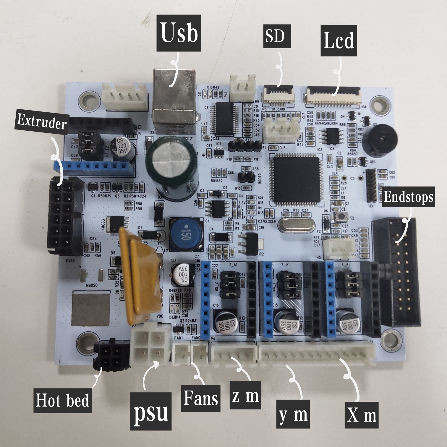

:D Hi,you can refer to this:
and if your motherboard is mini you can refer to this:
mini s 接线图.jpg (1.25 MiB) Viewed 8397 times

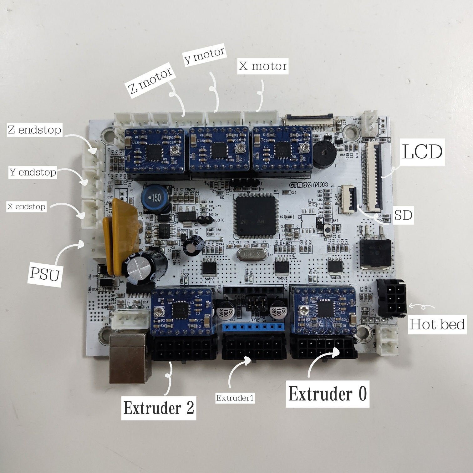

if your motherboard is GT32 PRO VD you can refer to this:
GTM32 VD 接线.jpg (1.31 MiB) Viewed 8397 times

Recovered almost all of the pictures and got on with it.
Almost all OK - only thing wrong is the heated bed warms up to 70-75c quickly and control via touchscreen or pronterface doesn't seem to work.
Any obvious suggestion to something I might have got back to front?

essex_chris
Posts: 11
Joined: Tue Apr 09, 2019 11:19 pm
Re: 12V A30 Disassembly guide?
Post by essex_chris »
Thanks - somehow i had the power wires in and out of the bed in the wrong way so when it was meant to me off it was on automatically.
