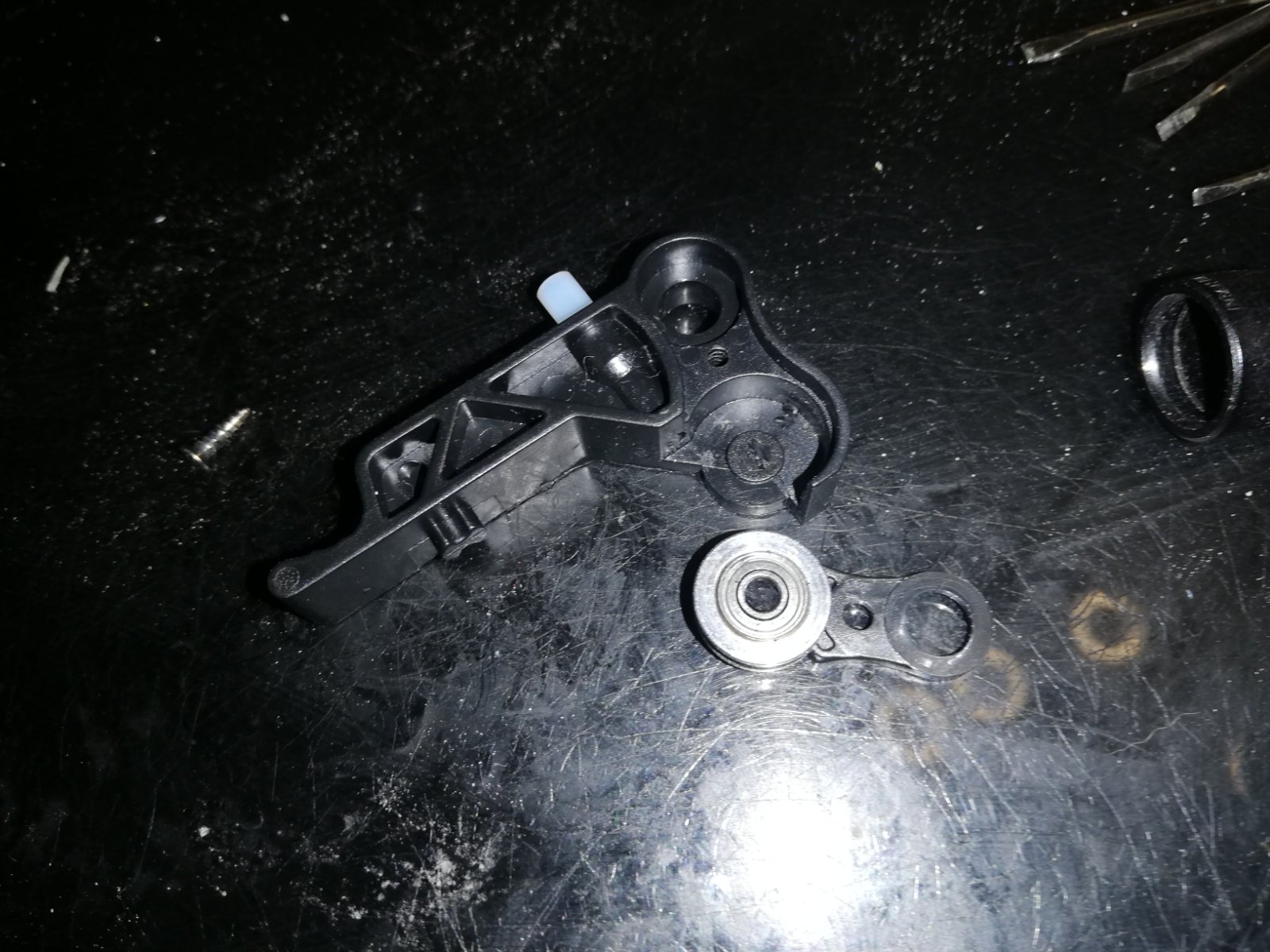

I found the problem when I check the gap between idler wheel and gear :
one piece is broken...
what can I do to use the warranty?

Hi,if this is the case, you can contact your salesman to say what the situation is and replace it accordingly.

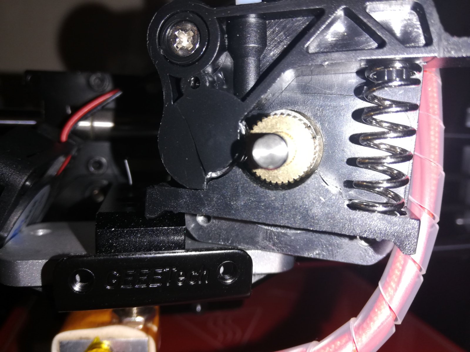

inside it's worse...

Hi Zolric,
In case you were not aware...
You can get an aluminium replacement version very cheap on ebay !
This is better than the plastic version.

Re: Extruder making noise and don't move after a few
thanks a lot, I was looking for something like this.
Plastic looks very poor quality...
