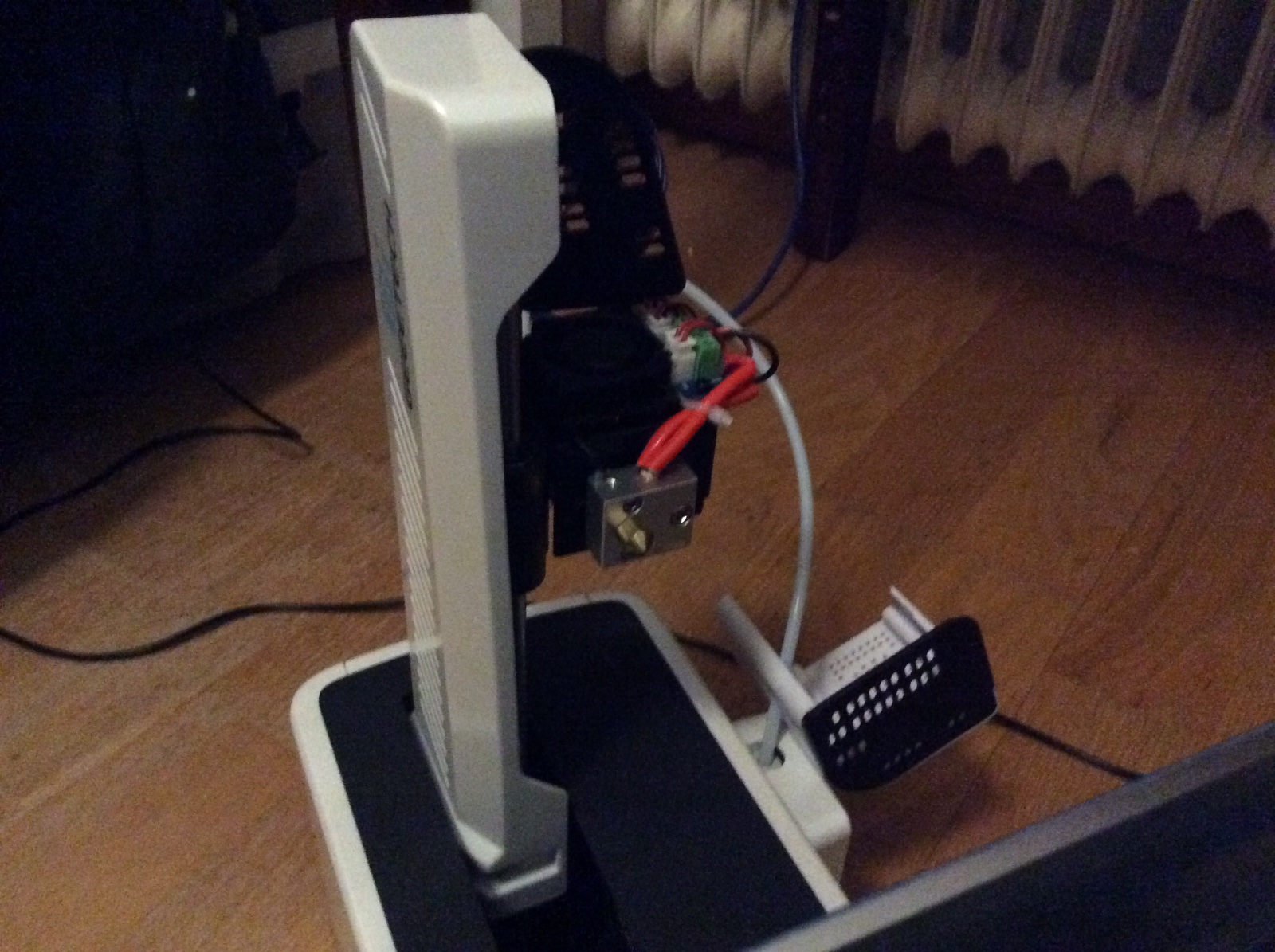

I have problem with filament. Its broken somewhere inside the printer in white tube that leads to nozzle.
How I get it out. Video in YouTube where u replace the nozzle has different nozzle. My printer is bit different. my printer looks like this.

Hi,Do you mean that the consumable is broken in the middle? You can remove the Teflon tube and remove the broken consumable. The nozzle can print normally?
Re: Filament stuck on printer
Yes its broken inside the teflon tube. So how i remove the teflon tube? Just pull hard or?
Hi,Remove the connected segment and see if the supplies can be removed.
So how i remove the teflon tube? Will I pull hard or do I need to do something first?
Hi,you can try to unscrew the Teflon tube connection position on the motor side
Is it possible to remove the teflon tube from nozzle end? Or how I remove the nozzle? Video in youtube has machine that is different than mine.
Hi,if you use such a nozzle, you can use a tool to remove the nozzle at a temperature of about 200 °.
