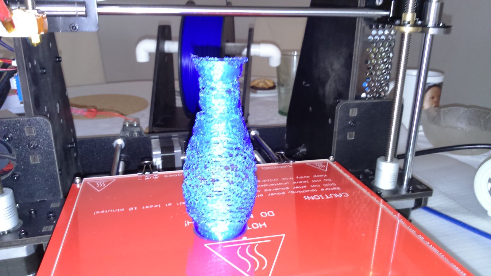

Hello,
I got a Prusa I3 Pro W and it was a nice job to assemble it. After everything seemed to be well done I printed the job vase.stl with the default settings. The software is EasyPrint 3D Version 1.2.6 and Firmware is V1.0.05.
The result looks a bit strange, the surface is not dense and compact but it is looking more open like a mesh grid. Is this how it should look like or what parameters can I set to improve the outcome?
Thanks a lot for your help.
Best regards, JuergenL

Hi,you can set the print speed to 30mm / s

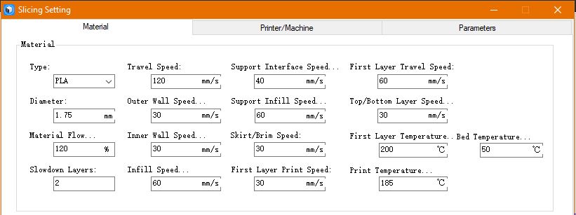

Hello William,
thank you very much for your immediate reply, but in the "Slicing Settings"-Tab there is no general "print speed" available, but all these (see picture).
Could you please again have a look and precise which of these I have to change?
Thanks again a lot.
Re: Printed Vase.stl file looks a bit strange
Hi,regarding your printing temperature, it needs to be adjusted to about 200 °

Sous-extrusion qui peut être due à de multiples facteurs .. ?
