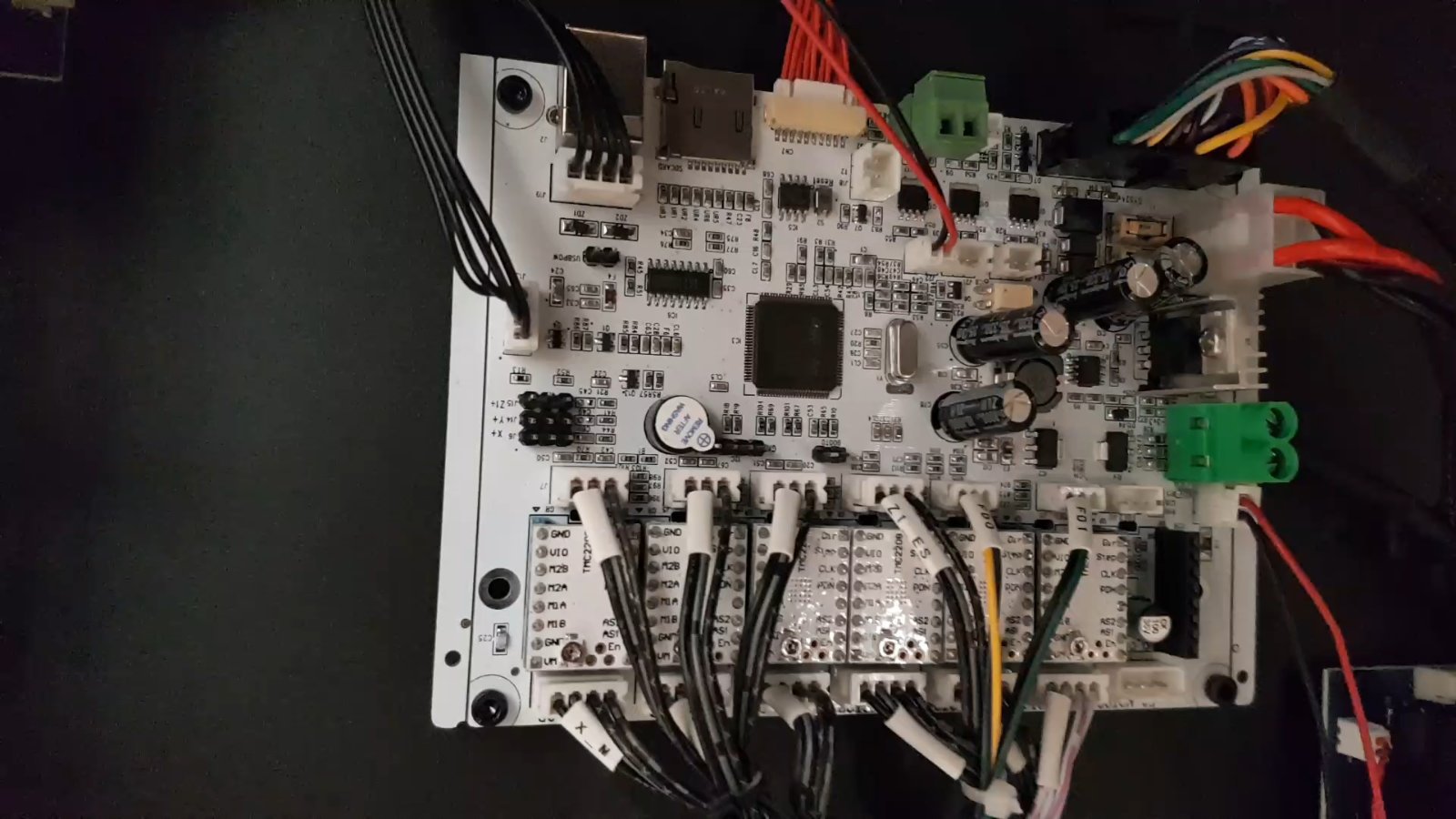

Somebody can help my please? i have a A30M .Witch Board is this GTM32 Mini, GTM32 PRO VD what else

Hy is have a A30M. And i have this board in the printer. somebody knows witch board used by my printer. i have crashed my firmware and i don't find the right. maybe i have destroy the board.
Before i flash the printer i read follow informations on the lcd .
Hardware version 1.2
A30M
Version 1.0
This is what my printer do.. i have flash with the false firmware. after that the printer do this.. look on this video...

Hi,you can check whether the corresponding model is written on the back of the motherboard.

i have solved my problem. Thx for all. it is a smartto mb v.1 board and you can flash with the original firmware from geeetech a30m for smartto firmware. you need the firmware tool from https://github.com/eokeeffe/Smartto :-)
