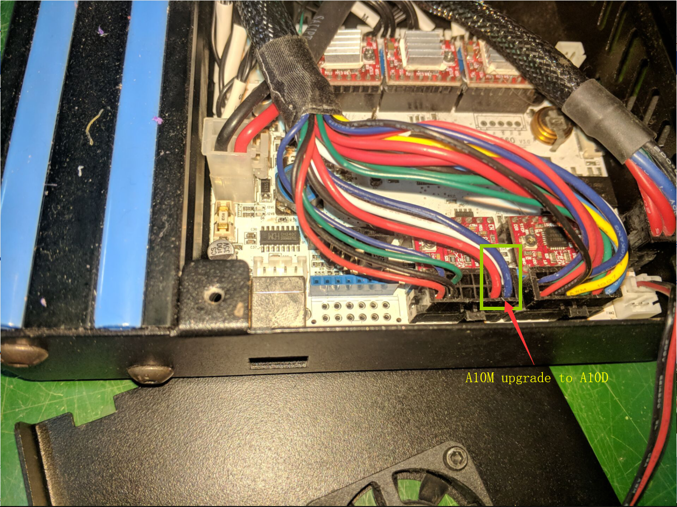

Re: A10 dual extruder upgrade
Hi,ripX
You can see the attached pic then you will know what I mean
a10m upgrade to a10d-1.png (2.29 MiB) Viewed 7058 times
As you can see there is 4 pin for the hotbar and thermistor(2pin+2pin).
For the pin definitions of the A10/A10M/A10D is the same"GT2560V3".
It means you don't need to change the firmware.
(Still, I suggest you check the power of the hotbar + the type of thermistor then tuning it in firmware)
