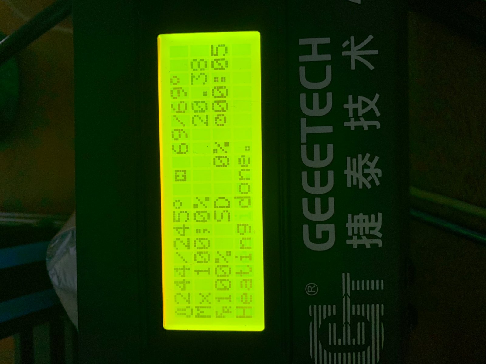

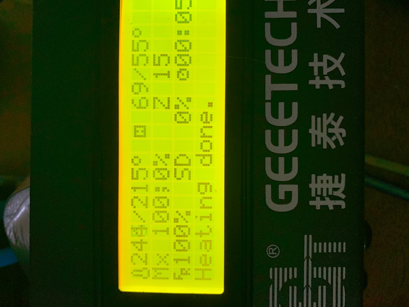

I have two printers. Both do this annoying thing where I set the temp I want in cura, send the job via USB, the display shows the set temperature I chose but as soon as the job starts, the printer reverts to the default 215/55 PLA temp. Please help its REALLY annoying. Image

Hi, do you set the print temperature in the slicing software,
Can you provide a video of the temperature change?

I am using Cura 4.5. I set the temps in cura and it changes. I tried uploading a video but it will not allow me to. Please provide an email adress and I can try sending to that. Thanks for your help

Settings stay when using Repetier Host. SO problem seems to be in Cura Version 4.5 that I have.

Problwm solved. Removed start Gcode in cura
M104 S215
M140 S55
