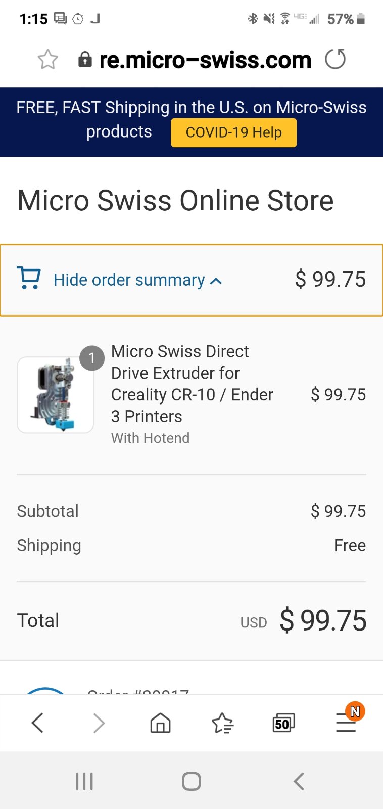

The whole Micro Swiss all metal extruder and hot end kit was less than a $100 and with the PTFE tube not going all the way down to the heat break it should minimize clog issues.
There are direct drive kits out there for 40 bucks or so. After piecing together a systems that has an all metal extusion system and a better hot end I realized it would end up costing me about the same or more than the Micro swiss all in one.
Included is a picture of my hot end disassembled Showing the hot end control board and the info on the Micro Swiss System I bought.
