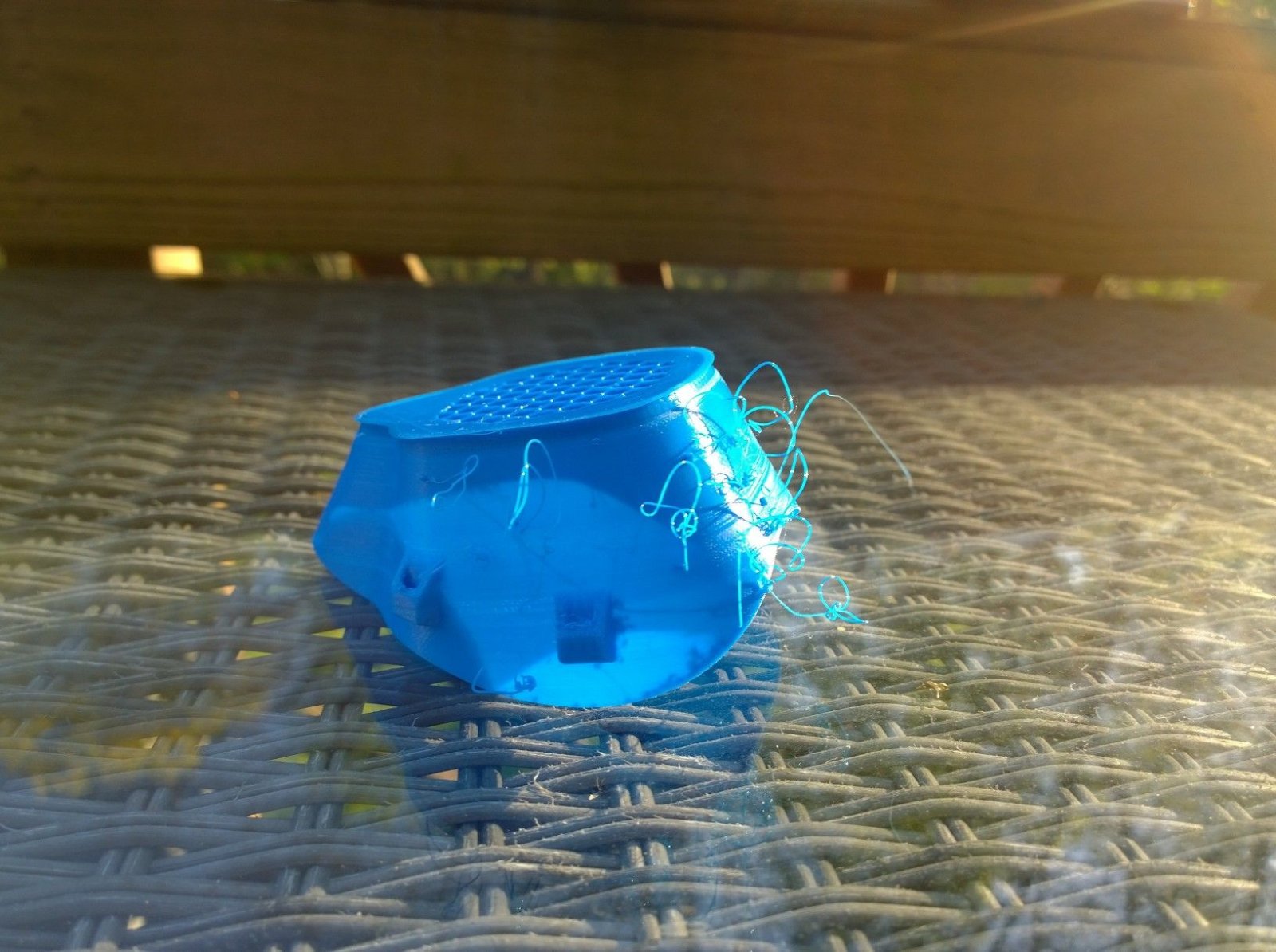

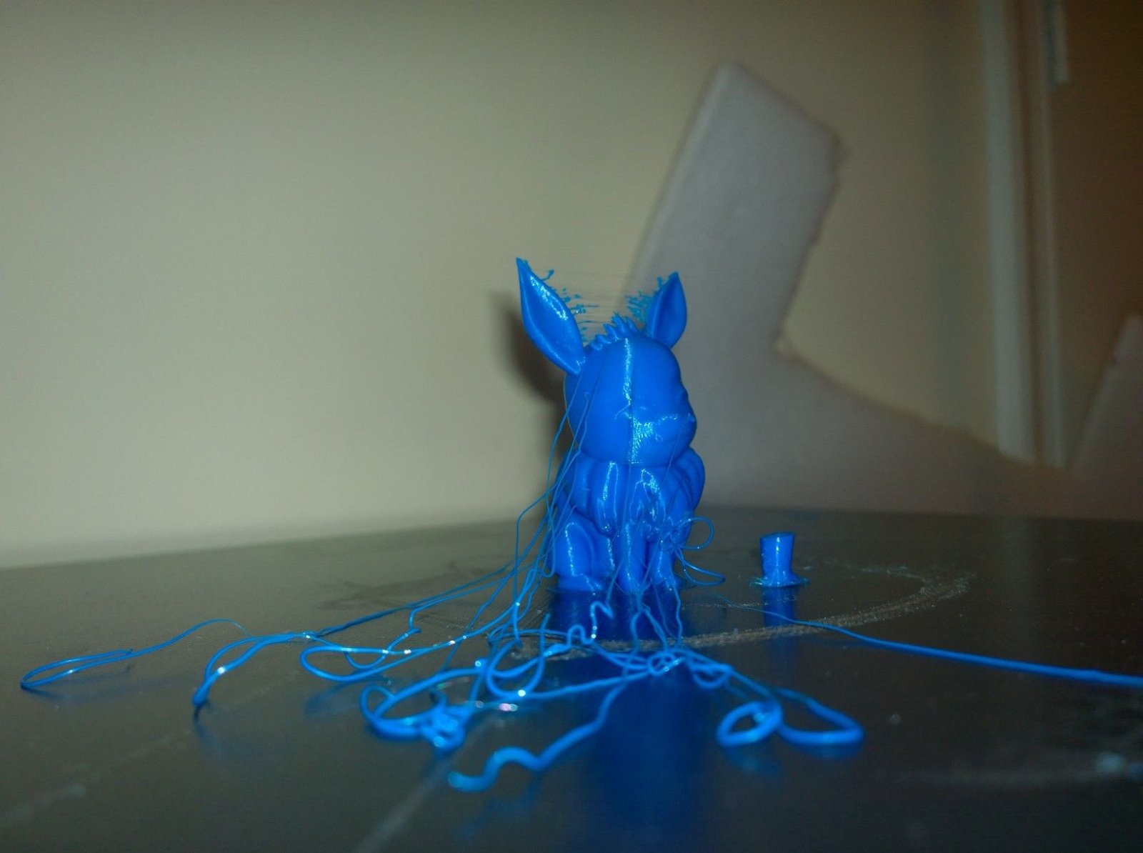

I have an A30 and I am having a problem with it constantly rebooting. The reboot seems random and happens at different times when using the same gcode. I run the gcode from the SD card and don't have any wifi. This prevents me from doing any large/long print time projects because I need to be able to click the "Play" icon on the display to continue where the print left off. This creates a lot of blobs when the nozzle moves back into position from where it left off. See the attached photos.
