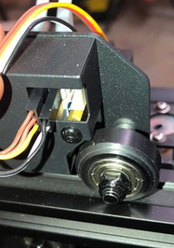

f) How do I install the 3D touch... no instructions at all... which wire should be where (Black at top, Brown at top? ) - I get a probing failed message...

6. You can refer to the picture when installing 3d touch. Brown is above 3pin and black is above 2pin. Incorrect installation may cause damage to 3d touch or the adapter board;
3d touch接线参考.png (140.09 KiB) Viewed 9719 times
