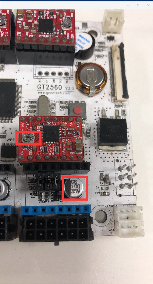

Hello, it may be that the drive direction is inserted reversely, causing the drive to burn out.
It is recommended that you recheck all connections and try again after replacing the good drive.

Hi, the knob on the drive and the capacitor on the motherboard are in different directions, as shown in the figure:

I see your orientation.
I think you're right: I had 3/4 in backward.

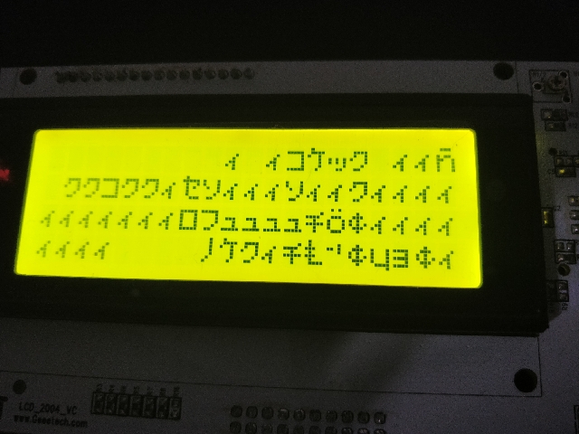

However, the LCD still isn't responding when I turn the knob. It's also still doing the weird characters if I let it sit for a couple min.
What do you think?
I've got the LCD_2004_VC.
What do you think?

8) The strange characters from the above pic did not appear when the Octopi was connected though the knob still didn't work.
