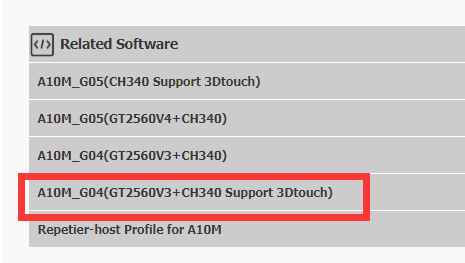

Where can I find the download source files for A10M GT2560V3 +BLTOUCH
Thanks
Re: A10M_G04(GT2560V3+CH340 Support 3Dtouch) source files
Hi,here:https://www.geeetech.com/download.html?download_id=31

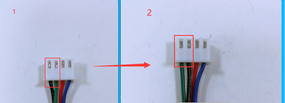

I want to change the drivers so I need to change the marlin source files.
Sorry, there is no source file yet. If you want to replace 4988 with 2208,
you can exchange the wire sequence so that there is no need to change the firmware
