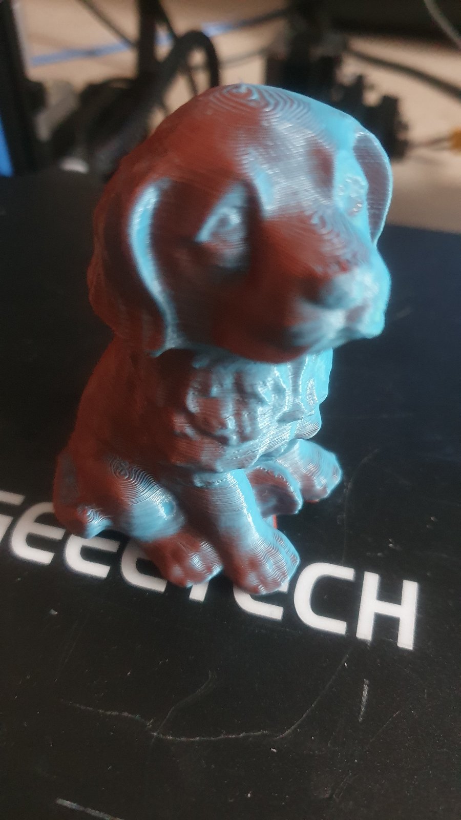

Hi all,
I'm new to the forum. I tried to dig a bit but i couldn't find an answer yet.
I've very recently entered in the world of 3D printing and bought the Geeetech A10M as the dual extruder kind of pumped me up (to the point that i almost regret not to have bought the A20T).
Regardless.. I quite like the printer but i'm facing an issue and i'm not sure if i have a real problem or my inexperience is playing the main role:
I'm trying to print with a color mix (in my case specifically i have red in one extruder and blue in the second attempting to have a grade of purple).
However the mixing is uneven... very uneven. The resulting model is a vertical split between the two colors.
The left side ends up being almost purple while the right side is light blue with no real expected mixture outcome
Is there anything i can do to fix this and have a full mix of the colors?

In theory my attempt is to have a ratio of 70-30 to result in a purple color (i'm using red-blue filaments that should result in purple as secondary color mixing them) so i would need both of the colors to "work at the same time" for a color switch.
When i try to print is like the filaments remain side by side rather than completely blending so they result of a different color depending on which side you look at it.
In other words, i would like for the two colors to blend in a 3rd one but the printer is partially "failing" to melt them into one.

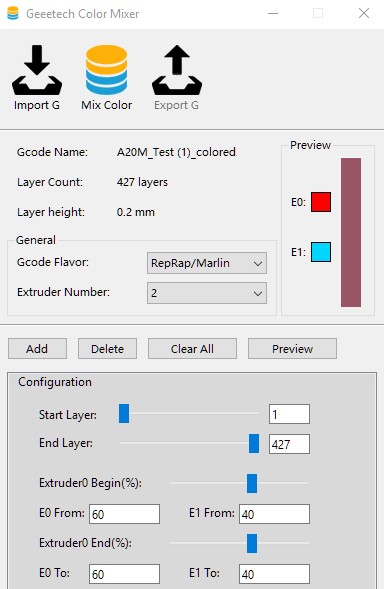

When i printed the model i wasn't attempting to have 2 different colors appear (i'm attaching the two sides of the same model to show the colors better) but rather a single one mixing the two (the two primary colors in a secondary color)
- 3D Printed dog.zip
- (1.14 MiB) Downloaded 501 times
- Color Mix setting.jpg (44.18 KiB) Viewed 10016 times

Hi, the color mix refers to Print in two colors separately,

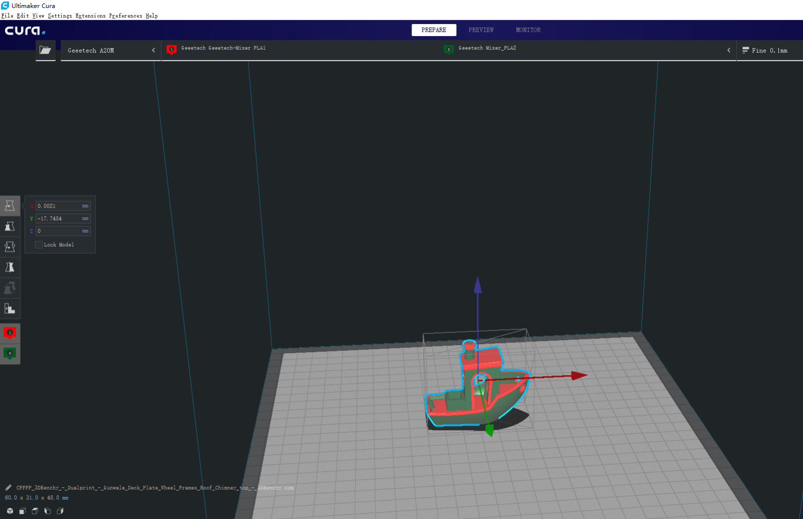

Iv been mixing colours on this printer for well over a year without any issues. This has been done via the display, cura and octoprint. The A10m is fully capable of mixing.
