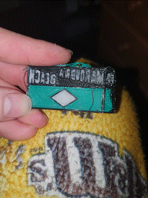

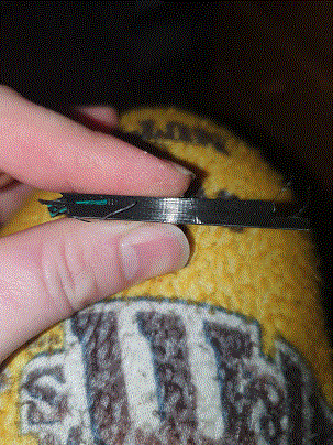

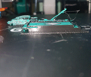

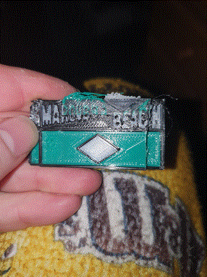

So after fixing up the extraction issue that I had, my A10T worked pretty well up until it started to change position on the X and Y axis during printing.
At first I thought that it may be due to no adhesion, but as you can see here the item is firmly in place on the bed and has not changed position from when it was laid down.
In these photos you can see multiple times that it has changed position during the printing process.

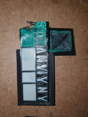

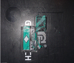

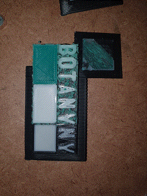

But it is not just limited to this particular print, here are two other examples that where sliced different ways that still have had the same issue!
So how do I fix this issue? at first I thought it had to do with the 3D touch that I installed so I removed it and re-flashed the firmware and did a PID tune for the extraction of the filament.
Any help would be great as I have no idea how to fix this issue and I really need the printer for my small business!!!
A10T changes X/Y axis mid print and then returns to another position

I have done all but step 3 on your list over the past week (as I am not too good with electrical stuff unless it is plug and play or basic home electrics) and yet I still get shifts in the layers.
It can't really be anything else other than something to do with the firmware/software interactions as I have recliced the files a number of times even changing height/position/direction of print and yet I still have the same issues.
I have set a camera up at the moment to see if I can lock down the precise moments it begins to change, but on one print yesterday it simply shifted the bed slight forward less than a millimeter on the Y axis over 4 seperate layers and on another a good 10 millimeters on 5 layers on the X axis.
I have cleaned all the V slots, tightened and loosened belts and wheels, printed cable chains, removed cable chains, and it is still shifting. It is driving me insane because on a couple of other files it doesn't do any shifting just prints out the file perfectly!!
