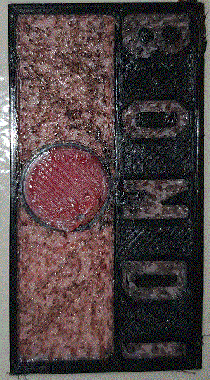

After having my motherboard fail and getting a replacement sent out fro Geeetech, I installed it into my A10T and also installed at 3DTouch at the same time. I flashed the firmware over and then went to continue printing with my printer.........only to discover that the quality has diminished to the point of disastrous!!!

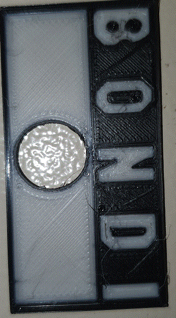

I used to get this quality out of my A10T but after replacing the motherboard, installing the 3DTouch and flashing the firmware I got this quality .

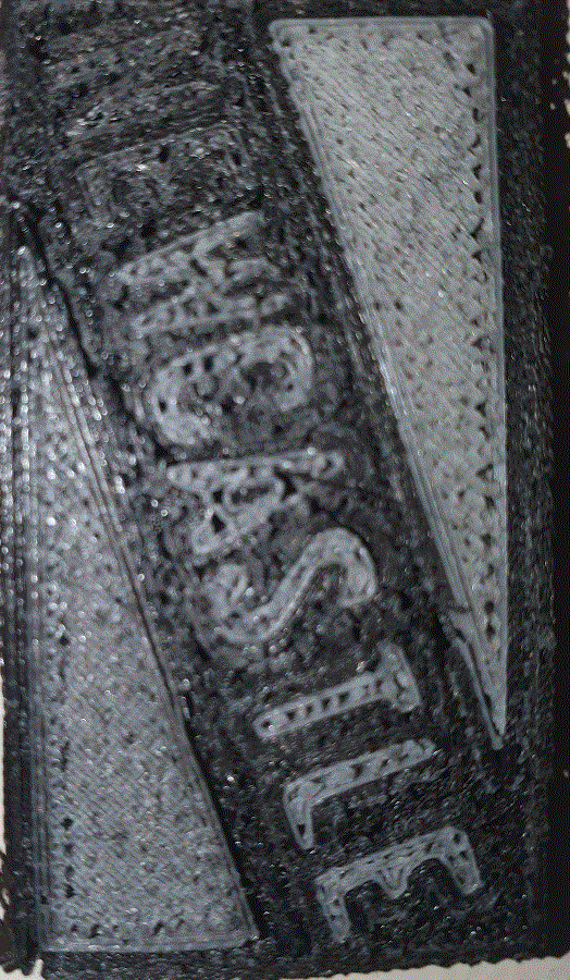

I thought that maybe the hot end was blocked so I cleaned it out and set it up for another print........only to get this.
I have no idea what is going on, I have tried adjusting the bed level and the nozzle levels, I have even tried changing the details in Repetier-Host what seems to be a thousand times and it just continues to print like the this .
I have even used files that I had sliced prior to the motherboard being changed and the 3D touch added as per this photo, but it still doesn't improve the print quality. .
Where is it all going wrong?? I have checked that all the parts were swapped correctly between the old motherboard and the new one, I have checked all the cabling and physical parts the only thing I can think of is there is a software issue somewhere and it is the same filament that was in the machine before the motherboard failure so I am fairly sure that it is not that.
I use my A10T for my small business projects so I need the quality it was providing before the motherboard failure, can you please help me as I have spent nearly 7 days trying to improve the print quality only for it to continue to give poor quality?

Hi!
Maybe you should do PID calibration?
If you buy printer as it is, it's already should be calibrated.
The new motherboard may have different PID values.

Re: A10T Print Quality
Definitely looks like under-extrusion. Calibrating is rather simple. Here is a video link: https://www.youtube.com/watch?v=PChOqIBNwOs
For this work, I pull the Bowden tubes out of the extruders, cut the filament at the face of the coupling, connect my laptop with Pronterface, issue this command line to extrude 100mm of filament. G1 E100 F100. If it extrudes less, then its under-extruding. Video explains well. I just go into the menu on the printer and change the esteps , and save the setting, then run the G1 E100 F100 again until I hit 100mm.
