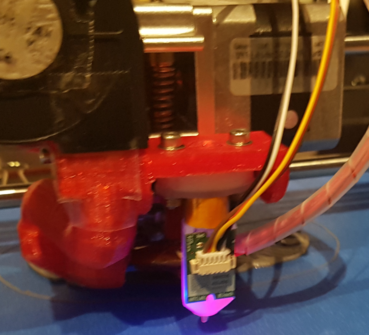

( I've attempted to attach a photo of my BL Touch - Blurred as I'm currently printing. - You can see the red bracket (Fan duct) has a white spacer before the BL Touch)
It is important that when the probe is deployed, the probe hits the bed before the print nozzle does !
It is important that when the probe is stowed, then it is above the print nozzle.
Have you looked around the menu on the printer - Have you found the section where you can select 'Self test' for the 3D Touch ?
You can deploy the probe and stow the probe. ( You can test see the heights it moves to quite easily when it's not moving )
Select 'Reset probe' before leaving the menu.
