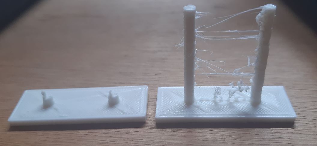

Hello guys.
Im having some issues with enabling retraction on my I3 Pro B, if i dont use retraction i get a lot of lines (see attach), but when i enable retraction (0.6mm / 25mm/s) the printer stops sending filament (picture also in attach).
Any ideas?
Thanks in advance.

I use 2mm and 40mm/s for retraction and all Ok.
Best regards.
